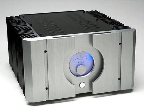

 Pass Labs
Pass Labs X350.5 Two-Channel Amplifier
Measurable Performance Characteristics
