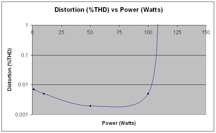

What is admirable on Yamaha's part though is that they still give full 20Hz to 20kHz bandwidth ratings at 8 ohms and a specific (maximum) THD figure for all models. These are the true wattage figures of which each individual power supply/amp section is capable before the "knee" of that power curve starts heading up.
Going back again; the 550 has 5 more watts than the 450 so what's the deal? Well, the units probably are made in different factories so the parts may be slightly different though rated identically. Similarly, the power supply is probably spec'ed identically but the 550's amp section may have the voltage rails bumped up just a tad to get that extra five watts. And that's the secret. Not much of a secret, huh?
Another item to look at is the weight of the 550 and 450. No difference. You're probably looking at identical power supplies and identical power amps, just different actual parts from different suppliers in different countries. And once again possibly, just possibly the 550's voltage rails are a volt or two higher than the 450 to claim the extra 5 watts.
Going up in the line to the RX-V750 and RX-V650 you've got an even more similar story. With identical weights you can be pretty certain that you've got identical power supplies with just the voltage rails bumped to make a couple more watts of power. Now onto the last way that 100 watts is still legitimately quoted…
That last and final way a couple of extra watts can be claimed for a receiver which has an identical power supply and power amp section is to simply quote power based on the higher distortion level of the curve after the knee as it heads up quickly toward the 1% level. By reading power figures off the curve after it's passed its lower distortion turning point or knee it's always possible to legitimately squeeze a couple extra watts out of a specification to keep the sales and marketing people happy. Just bear in mind that if you want to compare real watts vs. distortion you're always getting more accurate, real world figures on the horizontal section of the curve.
