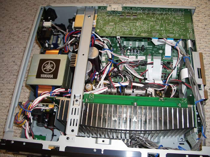

Yamaha RX-V2700For conventional analog Class A/B amplifiers, weight can be an indicator of good, robust design because it suggests that the amplifier’s important internal components--the power transformer, heat sinks, and storage capacitors -- are large, and therefore have plenty of capacity to process and store large amounts of power to handle loud dynamic peaks without distortion.
By contrast, an analog amplifier that weighs less may use a smaller transformer with inadequate capacity and fewer or thinner heat sinks (heat sinks look like radiator fins and are used to dissipate output transistor heat generated by high power output and big dynamic swings).

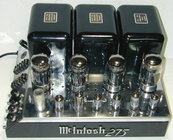

Tube amplifiers distort in a different manner from transistor amplifiers, generating musically agreeable even-order harmonic distortion that may lend a sense of so-called “warmth” to sound quality (the “warmth” is still a distortion or coloration; it’s not present in the source signal) and it’s this characteristic that most tube aficionados prefer. While tube amplifiers are often not as smooth or linear in frequency response as transistor designs and have other liabilities as well, when pushed near or past their output limits, tubes tend to gracefully distort, without the harshness associated with transistor clipping. However, tube amplifiers are limited in output power due to the tubes and output transformers.
Solid-state amplifiers, when pushed past their output limits, “clip” the audio waveform producing potentially harsh-sounding odd-order distortion that can be quite grating or unpleasant to the ear. On the other hand, kept below their maximum rated output, transistor amplifiers are very neutral and smooth and have none of the complex impedance interactions that may affect tube devices.

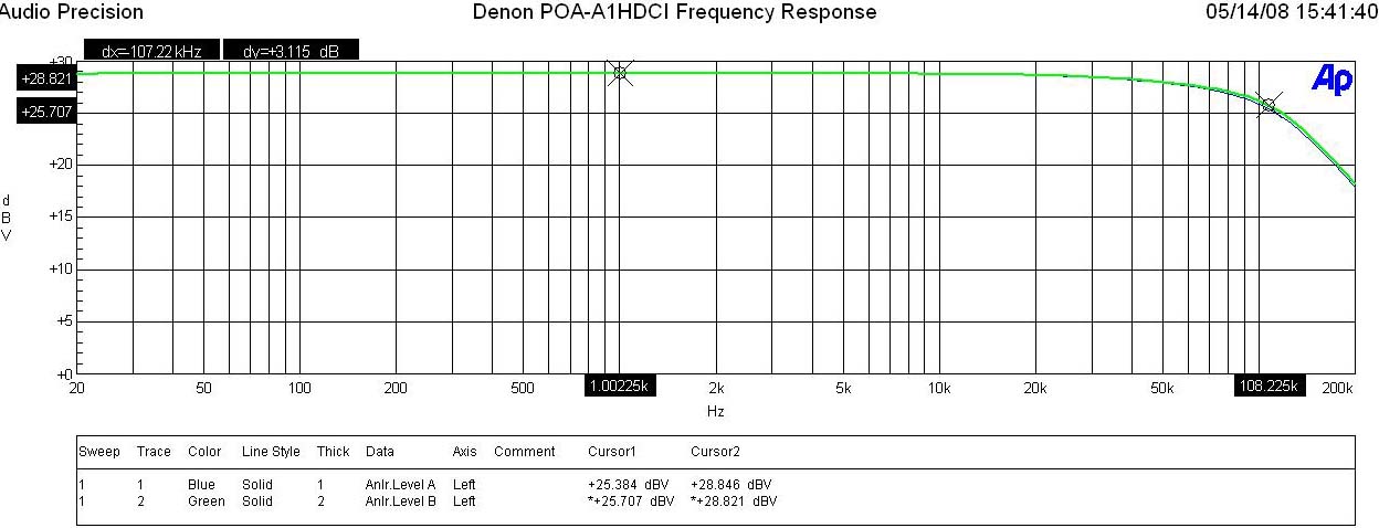

One primary attribute is a ruler-flat smooth frequency response from the deepest audible bass signals at 20 Hz (or lower) to the highest frequencies we can hear, at 20,000 Hz. A smooth, linear frequency response means that the amplifier will treat every incoming audio signal, whether it’s a bass-drum signal at 30 Hz or a cymbal’s high-frequency harmonics at 10,000 Hz exactly the same way, increasing the electrical strength of each tiny signal by exactly the same amount. Low total harmonic distortion (THD), below 0.5%, is essential so that any distortion artifacts remain inaudible with music. Finally, generous power output from a robust power supply so that the amplifier can handle the huge range of soft-to-loud dynamics present in virtually every type of music and soundtrack. “Generous” could be defined as a minimum of 50 to 100 watts per channel or more. For realistic music reproduction, more power is always desirable.

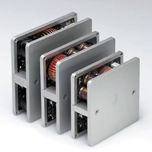

The Ice Power division of Denmark’s Bang & Olufsen (B&O) holds patents on its “ICE” amplifier, which is basically a Class D switching design (Pulse Width Modulator) with variants that B&O claims reduce distortion to levels associated with Class A amps, while retaining the high efficiency of Class D switching designs. ICE amps use a very high switching frequency of 384 kHz, which B&O says is 20 times as high as the highest frequency the ear can detect. The ICE amps also use feedback control to minimize the effects of the PWM design. Axiom’s engineering division took a different approach in the A1400-8 amplifier design. Axiom worked with International Rectifier to develop new silicon output devices and drive the MOSFETs in the output stage in such a way as to produce a perfect Pulse Width Modulated square wave at the output before the reconstruction filter. This approach also simplified the feedback network which made the amplifier more robust in its operation without being subject to oscillations or instability. The A1400-8 also uses a very high clock frequency (450 kHz) to allow for excellent transient response and non-aliasing in the audio band. The massive power supply is able to accurately output very high current and voltage to the loudspeaker over extended time periods.
