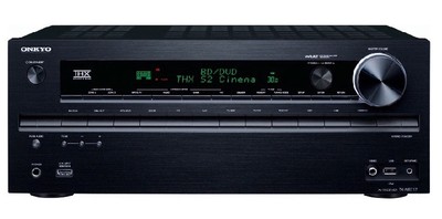

 Onkyo Receiver2
Manufacturers often increase the functionality and flexibility of the feature set as they move up from one model to the next. The power ratings are often rounded into nice, “comfortable” numbers, so they make  sense from a marketing standpoint. If model “A” is 75 watts x 7, then model “B” with 2-zone capability, more HDMI inputs, better digital decoding circuitry, and a logical step to a nice round “100 watt” x 7 rating gives models A and B a legitimate reason to co-exist in the lineup.
As an example, the Onkyo TX-NR717 at $949 versus $649 for the next step down TX-NR616, are fairly logically priced, with power ratings and feature sets that seem perfectly commensurate with their asking price. Just be aware that in the real world, 80 and 100 watts (of similar amplifier design) will sound virtually identical. But if you absolutely must have that additional HDMI input, it’s priceless, no?

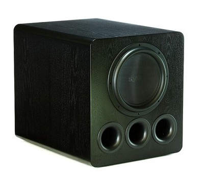

 SVS Sub
The SVS PB12-Plus. At under twice the price of the PB12-NSD, it delivers on average 6dB more clean output relative to its little brother, i.e. twice the sound pressure. Combined with its superior feature set, the value becomes a little more apparent. But what do our ears make of this?

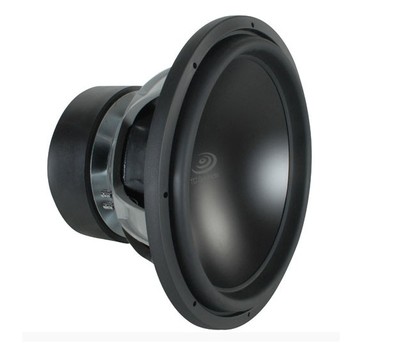

TC Sounds Driver
The TC Sounds LMS Ultra 5400. For deep bass reproduction, there is no replacement for displacement, and an 18” driver with 33mm of Xmax has a lot of it!

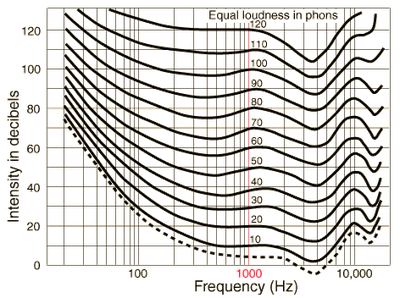

Equal Loudness Curves
To start, it is worth taking a look at an equal loudness curve. You’ll notice that the threshold of hearing varies by frequency (it takes a large amount of acoustic output for us to hear a 20Hz tone, relative to 1kHz for example), and if you study the curves closely, you’ll being to see how the ear perceives jumps in SPL. At 1kHz, a 10dB gain correlates with a perceived doubling of loudness in some frequency ranges. As you go down in frequency, however, you’ll find that the lines start to compress together: Instead of needing a 10dB gain to double perceived volume, you will need roughly 4-5dB in the deep bass frequencies. Further, remembering that we feel as well as hear deep bass, and taking into account that a 6dB gain corresponds with a doubling of acoustic pressure, one may better appreciate the previous example of the SVS PB12-Plus versus the PB12-NSD.
