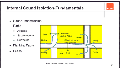

Our first three courses in the CEDIA Seminars series covered proper system calibration after installation and set-up was complete, followed by two complementary courses on room acoustics. More often than not, however, a great home theater must be capable of co-existing within the framework of the day-to-day goings on in the rest of the house and its occupants. This is where an understanding of how to isolate your home theater so as to control the inevitable noise leakage of dinosaur foot falls and anti-aircraft guns in the rest of your home's living space can be a really good idea.
Steve Haas' company, SH! Acoustics, www.shacoustics.com specializes in room isolation and noise control. In the best case, Steve and CEDIA-certified specialists like him should be called in during a home's initial design so that he can coordinate with the home's architect. Retrofitting of fully isolated home theaters is also possible, though sometimes much more time consuming if, for instance, existing wall structures need significant modification.
Most of the basic principles presented here can also be applied to dual-purpose rooms. It is possible to achieve moderately better overall dynamic range with attention to details such as suppression of A/C noise, plumbing and room- induced rattles. What will not usually be possible with dual-purpose rooms, however, is the attainment of the greater degree of isolation from the rest of the house, especially in the bass frequencies. It is this greater degree of isolation which can add ~20dB of dynamic range to a system. This is a huge expansion of dynamic system capability. And it cannot be achieved by any other (sane) approach.
The goal of room isolation is two-fold:
  • Provide an environment free of extraneous noise and vibration intrusion (within the home theater).
  • Prevent theater sound from interfering with other home activities or neighbors.
That first statement in bold above should be a goal of all home theater or music listening environments. We will talk about terms and measurements which can be used to describe the absence of extraneous noise in the pages following. The most important point to be made here though is that every 3db of extraneous noise eliminated in the listening environment results, in essence, in a 3dB gain in dynamic range. And properly executed, those 3 dB can add up quickly. Contrast these multiple 3dB gains with the single 3dB gain experienced from a doubling of amplifier power and the efficacy of proper room design becomes much more appealing. Let's define….
