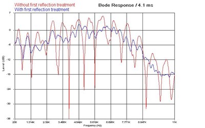

Early reflections
Early reflections are those which reach the listener within a delay of 15 ms relative to the direct signal. The retarded sound creates phase problems by combining to the direct one. The result is numerous dips in the frequency response. This phenomenon is called comb filter.
treated vs un-treated room
Frequency response with treated and untreated first reflection.
The red line shows a comb filter.

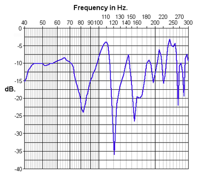

Standing waves
Standing waves (also called room modes) are low frequency resonances that take place between two parallel reflecting wall surfaces. They result from the interaction of wavelengths (λ) and the distance between the surfaces. So in the low register, standing waves cause: a level boost at some frequencies, an extent of the duration of sound at those same frequencies (resonance) and some profound dips at other frequencies.
low end response
A typical listening room low frequency response.
The phenomenon does not produce itself the same way at different locations in the place. This is why low frequency response vary from place to place in a room.
Three methods are used to solve standing waves problems. They will be discussed in the next article.
