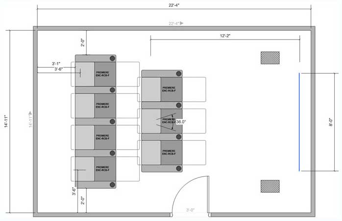

Concept Plan
The concept plan adds the basic acoustical treatment into the room. This calls out all the surface treatments, floor type, ceiling construction, absorption, diffusion, and trapping within the room. It will also give a good idea of what the room will look like from a 2-D plan view. In addition, the concept plan is a good time to be considering budgets as well as aesthetics. Different treatments have different building costs associated with them, and while we can not know precisely what a contractor might charge, we do know how to trim costs. The caveat is that it is usually at the expense of either aesthetics or sonic benefits of the room. Once this phase is approved, we move to the schematic phase.
Keep in mind the three aspects I mentioned earlier in this phase: budget, sonic benefit, and aesthetics. You should have some sort of handle on these during this phase, though don't ask the designer/engineer specifically what it will cost. They are not builders and should not be expected to give you estimates. Your builder will have to do that. But the designer can design in certain ways that can be expected to reduce costs.
I use an analogy with many of my clients of a kitchen. Imagine the A/V components are your appliances. You need cabinets and countertops and floors. You can have granite countertops, natural cherry cabinets, and beautiful stone tile flooring. It will be expensive, but look great. Or you can have formica cabinets and countertops, with a vinyl floor. It will function fine but won't look like the previous kitchen. You'll have a lot of extra money to spend on software (or fine wine) too. So you need to decide what's important to you. We often ask clients to look through magazines and tear out pictures of rooms they find appealing. Acoustics don't have to look like anything in particular. A creative designer can integrate them into almost any decor. We often use coffered ceilings, columns, and bookcases, as a way of integrating the acoustical needs of a room.
Some designers even provide 3-D pictures of what the room will look like. This is a nice added touch if aesthetics are very important to you and you have trouble visualizing what things might look like. However, these 3-D renderings are generally not cheap. Also, if they are going to this extent, the design is likely complex and thus relatively expensive to build.
Like the previous 2 two phases, don't be afraid to ask questions and even offer suggestions of what you might like to see. This is really the last phase that the client will have input on, so it's important that you are really happy with the results at this point.
[RoomSize] Schematics
The schematics have floor plans, together with all the details and assembly drawings, and often elevations where applicable. These are the details required to build the room. Also during the schematic process we verify the preliminary work done in the concept phase, and insure that we have the right amount of absorption, diffusion, and trapping, so there are likely some small modifications made from the concept plan, but they are relatively insignificant to the client.
The schematics complete the design phase. These can be given to a contractor(s) to bid on the project. Most contractors have never seen an acoustically engineered room before. That's okay-don't panic (yet). If your contractor doesn't ask, and doesn't call the engineer and designer to inquire, about some aspects of the design, you're in trouble. Don't hire that contractor, pick a different one. Then call the designer and get his opinion on the questions that were asked. Were they good questions? Did the contractor seem to have the right idea and perspective on the project? Your designer can be very important here because he will likely be communicating with your builder during the construction phase. Listen to him, and don't necessarily pick the lowest bid.
