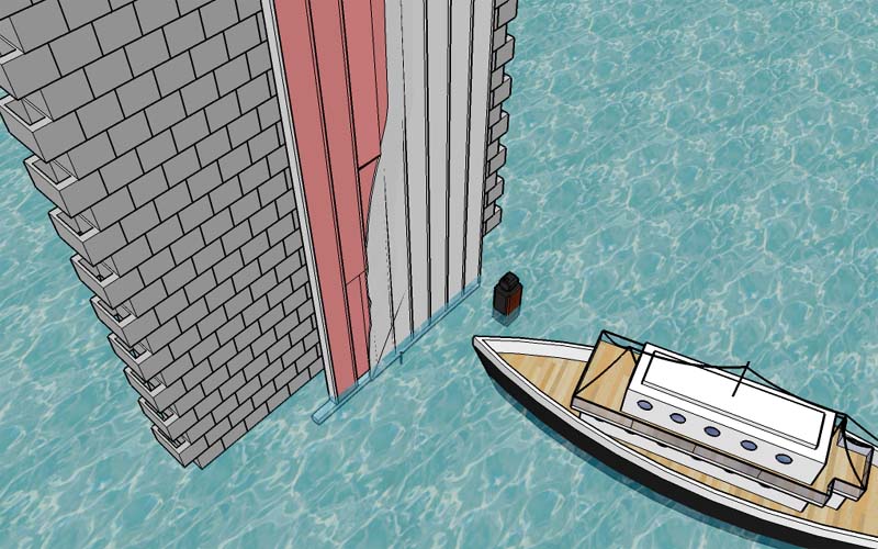

Imagine this being a typical interior wall system and the water represents the bass waves from your speakers.  You can easily see the yacht will topple the stud wall upon contact.

Now you see the type of construction (in relative terms) needed for critical audio. The bass waves will bring the yacht to the wall. It will rise with the pressure against the surface and then gently lower when the wave cycle ends. This is how bass waves should behave.
