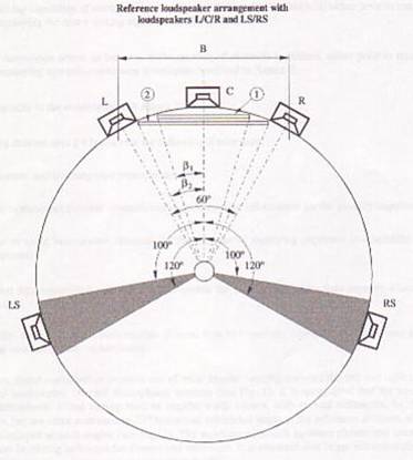

Left and right front speakers should be positioned at ±22.5° to 30° from the 0° center-channel and pointed toward the listener(s). The dialogue-heavy center channel needs to be immediately above or below the video display (or behind a perforated screen) and toed-in toward the listeners' ears.
ITU-R BS.775-1 (for 5.1)
Note: The 22.5° L/C/R inner angle (not shown) is an addendum to the ITU standard that was instituted by an agreement between THX and Dolby
Studies have shown that because of the brain/ears' head related transfer function (HRTF) our ability to accurately locate a sound source directly in front of us is an amazing ±1°. And with left-front or right-front sound sources at the prescribed ±22.5° to 30° (and toed-in toward the central listener) we are generally good to ±4°. ) Vertically our top-to-bottom localization acuity remains pretty consistent up to around ~+30°. Higher than +30° or so (as in ceiling mounted L/C/Rs) and the old HRTF starts working again and the left ear can begin to hear direct sounds from the right speaker (because it's no longer completely shielded by your head) and vice versa. Therefore:
  • Keep L/C/Rs as close as possible to the same horizontal plane . Panned cars going from left to right across a screen are easy confirmation of the veracity of this L/C/R recommendation.
  • L/C/Rs mounted horizontally across the top of the display device will fall under the +30° maximum angle (to the listeners ears) if the recommendations for the +15° max to the screen center (from the viewer's eyes) is maintained.
  • With bottom mounted L/C/Rs, point (up, if necessary) toward listening position and make sure that no coffee tables, legs, etc block the path toward the ears.

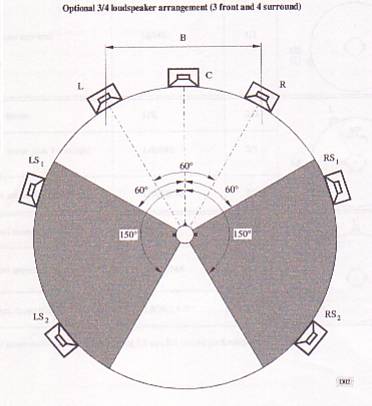

In the "optional ¾ loudspeaker arrangement" of the ITU 775 definition left and right (side) and rear surrounds are situated ±60° to 150° from centerline. Curiously, most articles I've seen show only the mid ±110° location for the (side) surrounds (the 5.1 system). Part of the wide, side-placement parameter allowance is again related back to the HRTF. When, for instance, a left surround speaker is placed within these angle parameters only the left ear hears the direct sound from that speaker. The ears/brain directional ability becomes severely degraded because of the loss of higher frequencies in the direct sound to the right ear (which are blocked by the head). So, fortunately for the envelopment goal, human localization ability to the sides is only accurate to ±15° front-to-back (but improves in the vertical direction). Many people have claimed that their side localization capabilities are much more accurate. But when those same people have participated in single-blind testing wherein the side surrounds cannot be seen then the naysayer's true capabilities have reverted back to the wide, ±15° window of localization uncertainty. This is much worse than the nearly ±1° horizontal and ±1.75° vertical localization ability in the front hemisphere.
ITU-R BS. 775-1 (for 6.1 & 7.1)

Optimal vertical placement of the left and right surrounds is also vitally important to maintain the illusion of envelopment. Vertically, surrounds should be placed at least two feet above the listeners' heads and not pointed toward the listeners but rather aimed so the main wavefront (for monopoles and bipoles) or lack of wavefront (for dipoles) is at a 90° perpendicular angle to the floor and over the listeners heads. Getting too close to the ceiling, which is usually past +15° elevation from the central listener tends to call too much attention to the upper direction of the left and right surrounds. As you'll see, a too-high surround mounting position was one of the major location compromises I had to make due to my particular room layout (and more significant other). In my system, submarine scene envelopment like U-571's depth charges sound just fine but an off camera door-knock sounds positively weird.
Finally, left and right rear surrounds (for 6.1 and 7.1 channel systems) should be placed at ±135° to 150 (ITU 775 rec.) to 170° (in a pinch). Therefore there should be both left and right rear surrounds spaced at least 6' apart, even if they must work from a single rear channel amplifier. When we get to pictures of my personal home set-up it will be seen that dual, 90° opposing monopoles mounted close to the ceiling were my only option. Were I to do it over again I would have spread the two rear surrounds at least four feet out on either side from the 180° rear centerline.
