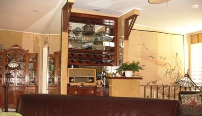

Sofa back looking from left front speaker. Rear JBL SP5 5 ¼" two-ways in lit corner on right . Glass curios do not rattle thanks to Quakehold. Rare 1956 tube RCA "Magic Eye" AM-FM-SW-1-SW2 radio has 3 front speakers and a speaker on each side. Sounds absolutely beautiful!
There was more to my wife's dance though, much more. As she whirled around our dual purpose living/home theater room her side glances were noting that I hadn't changed anything else in the room. Her prized (and highly vibration-prone) porcelain and glass souvenirs, gathered over many years of travels, were still in place on their glass shelves over the wine rack situated just six feet behind our sofa. (Thanks! Quakehold) Plus, she noted, I hadn't removed any of the tchotchkes that reside on our glass coffee table or over our fireplace mantel. Nor had I added any passive absorption or diffuser panels. And best of all, our modest and color-matched in-wall surround speakers hadn't been replaced. They remain as unobtrusive as ever; 5.25" JBL two-ways, color matched and blended into her faux Tuscan-style walls in the only areas she graciously allowed me to place them. The Audyssey acoustic alchemy machine had received the highest recommendation my wife's "golden ears".

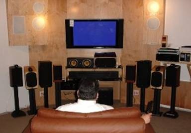

Custom installation companies who have their own showrooms have usually considered themselves ahead of the game. They can present a well integrated (read: possibly some hidden passive room treatment) and calibrated example of a "typical" A/V Media room with which to sell their expertise.
What this author has found, though, is that you may get the couple to enter an unfamiliar room but still have difficulty in getting the couple to sit down in the sweet spot to listen to and view the marvel that is high performance A/V. And once the female partner sits down she may immediately start thinking about the fight her iPod-generation kids will put up for that same sweet spot when the parents aren't around. In short, the "every seat a good seat" audio goal as taught in John Dahl's and Anthony Grimani's CEDIA courses has been an elusive one at best.
