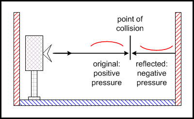

The most common application of bass traps in recording studios and control rooms is to minimize standing waves. (See the sidebar Why They're Called Standing Waves below.) As you can see in Figure 1, standing waves develop inside a room when sounds bounce off the floor, walls, and ceiling, and collide with each other in the air. Left untreated, this creates severe peaks and dips in the frequency response that change as you move around in the room. At the mix position, there might be near-total cancellation centered at, say, 100 Hz, while near the back of the room 100 Hz is boosted by 2 dB but 70 Hz is partially canceled. Although it seems counter-intuitive, a device that traps low frequencies will in fact increase the amount of bass a room can produce. When the cancellations caused by standing waves are eliminated, or at least reduced, the most noticeable effect is improving the bass level, quality, and clarity from your loudspeakers.
Figure 1: Standing waves in a room combine in the air to create peaks and dips in the frequency response.
Here, a positive wave front from the loudspeaker (left) is reflected off the wall on the right, and the reflection collides with other waves that continue to emanate from the loudspeaker. Depending on the wavelength (frequency) of the tones and how far you are from a room boundary, the reflected waves either add to or subtract from the waves coming from the speaker. Worse, different locations in the room respond differently, with a boost at some frequencies and a reduction at others. The action of sound waves colliding and combining in the air is called acoustic interference. Note that this phenomenon is not limited to only those frequencies related to a room's dimensions - all low frequencies combine in the air to either increase or reduce amplitude, depending on the size of the room and where you're standing or sitting.
