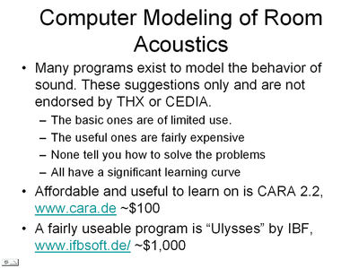

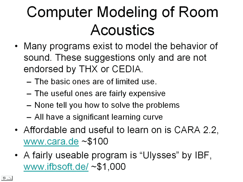

Below ~150Hz wavelengths become much longer and are thus able to interact strongly with most rooms. A 150Hz wavelength is 1130/150 = 7.53 feet so it is capable of reacting fairly strongly in a room with an 8 foot ceiling. Wavelengths below 150Hz get progressively longer and can now begin to interact with higher ceilings and other room dimensions. Potential problem frequencies within a rectangular room can be approximated by using several freeware programs which are readily available. John had suggestions for more sophisticated room modeling programs as well:

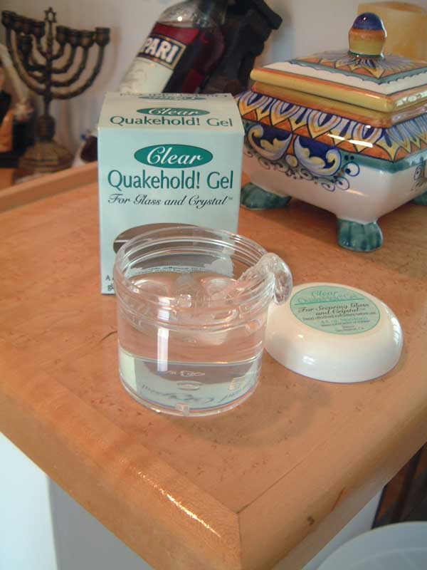

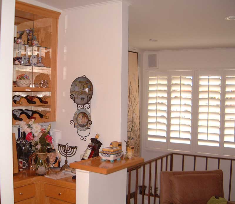

In the small bar alcove in my home listening area we have a couple of very nice display plates collected from a European vacation. We display the plates are on the bar-wall, supported by a decorative twisted wire frame. When I was calibrating the Infinity sub the first time and the CD hit the 56Hz band, those two plates started rattling like mad against the wire frame. A simple application of clear "Quakehold! Gel" at the three points where the plate touched the wire frame solved the problem. I had found this product at our local True Value hardware store. But for those of you not living in California earthquake country I can also recommend Dap Fun-Tak which is available at most Home Depots.
