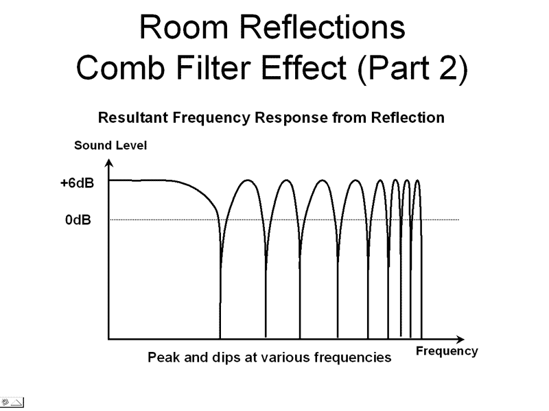

Bass frequencies are generally those tones from 20Hz up to ~200Hz. Beyond 200Hz are the mid frequencies with the high frequency range beginning at 2000Hz. The distinction between the bass frequencies and the mid and high frequencies is profound because of the difference in the way each of these sets of frequencies act within the room. Those above ~200Hz are usually not long enough (5.65 feet = 200 Hz) to interact aggressively with any of the room's dimensions, a typical 8' high ceiling for instance. But they can cause havoc with blurring of images or spectral imbalances caused by comb filtering.
The comb filtering phenomena has seldom been explained with such clarity as did John Dahl.
From the slide above we see the proverbial problem of the direct sound versus the indirect sound. (And remember, without room treatment and at most typical listening positions we're getting roughly the same amount, 50% direct and 50% indirect sound.)
The reflected sound is t2. Because it travels a longer distance to reach our ears its arrival is delayed by a few milliseconds. As you can see in the two charts (to the right in the slide), that particular frequency can become either additive in nature or it can exactly cancel the direct frequency. These are the two extremes. In reality the distribution of any particular frequency in time is almost always somewhere in between these purely additive or completely canceling extremes. What we get instead in those t2 frequency waves are the following series of additive and canceling effects which, as frequency increases, start to resemble the teeth of a men's comb.
These t2 waves look quite different than the t1 sine waves which reached your ears a few milliseconds earlier. So it becomes easier to understand why, left untreated, these mid and high frequency reflections become so destructive to the primary sound.

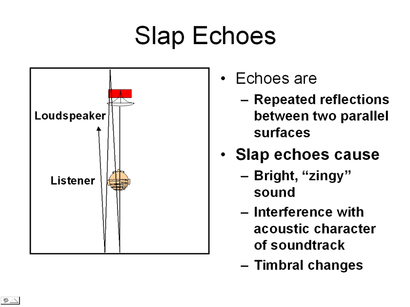

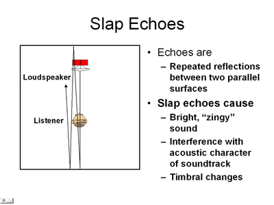

Slap Echoes
A variation of the axial reflection is the slap echo.
The difference here is that slap echoes occur between two parallel surfaces. This form of acoustic interference is very common in living room layouts wherein the sofa at the listening position is very close to the room's rear wall. Slap echoes need to be absorbed to avoid a bright zingy sound which interferes with the acoustic character of the soundtrack.
Common solutions covered by John Dahl were both absorptive and diffusive in nature. Plus, we learned later on that where you place the absorptive material and where (and when) you place the diffusive material is also tied in with proper placement and type of surround speakers. Thus, it became more obvious as we went along how all the speaker systems' ultimate performance where intimately tied in with the room and proper placement of absorptive and diffusive "systems" within the room.
