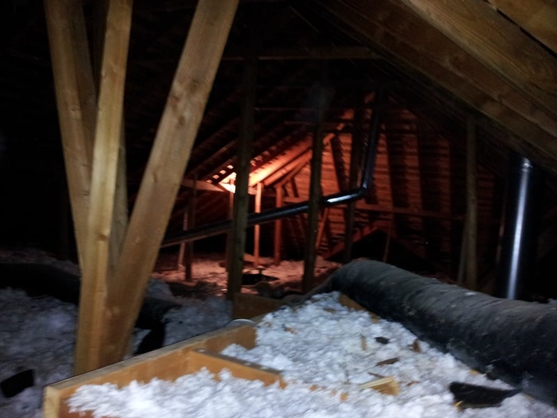

  • Through the attic or in the basement – If you have an open attic above or unfinished basement below where you are working, then you have it easy.  The only advice we can give you  is to look for markers in a home (electrical outlets, ceiling fan, etc..) to help you find your way around in the attic or basement. The best method is to get a thin piece of metal, often times called piano wire, and drill it into the basement or ceiling from the main level. Then, when you are in the basement or attic you can find the piano wire and know exactly where you are at. If you are feeling cheap a coat hanger can work as well.
