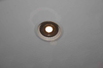

Cyron sent us four of their PAR38 lamps in "warm white" so we could check them out first hand in a residential application. These are exactly the kinds of lighting you'd see in an in-ceiling application designed to shine light down on a wall or floor to accent or illuminate a particular area. In our application, a kitchen with dimmable lighting, we replaced four 125W in-ceiling flood lights with the comparable LED solution - the PAR38. Since 4 PAR38 lamps replaced 500 watts worth of incandescent lights with just 60 watts, the energy savings was an astounding 88%!

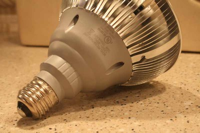

Each of the Cyron PAR38 lamps illuminates using 12 LEDs arranged in a circle. Each LED has its own a dispersing dome that spreads the light outward and meshes it with the adjacent LED (these LED lamps don't work using a concave reflector as some other solutions do). The beam is a tad on the tight side rather than the flood pattern of a conventional in-ceiling flood bulb.
Around the LED array is a black surround and a passive aluminum heat sink delivers the required cooling for the integrated dimmer assembly encased within. Aside from the fins, the outer shape is the same as a traditional flood lamp. As for output, the PAR38 emits a full 900 lumens in the "warm white" version and 950 watts in the "daylight white" model. That's about as bright as the calibrated lamp of many home theater projectors. The bulbs truly blow away incandescent technology in a variety of ways, but possibly none more impressive than how long they last. Each of these lamps will last around 30,000 hours. A traditional bulb is lucky to reach 1000 hours. That means you get 30x the life. It doesn't take long to do some rough figuring and quickly find out how much you can save in just time and energy alone. Remember, you can factor in both the replacement costs as well as the energy savings. Together, LED lamps just make sense.

Now, specs are cool and it's fairly obvious that LED lighting is the future - and a welcome one. But you have GIT to experience the sheer brilliance (no pun intended) of a true daylight bulb in your home. While the super-warm 3000K bulbs might be what we are used to, a D65 or 6500K lamp (as the one we reviewed was) is like casting sunlight into the room. In our kitchen test location, it truly felt like we had installed four mini sky lights to let in sunlight. This particular kitchen didn't have any windows (being located in the middle of a home) so introducing refreshing 6500K light was unbelievably beautiful. It made us want to replicate this color temperature of light in every room in the home - it's THAT beautiful.
