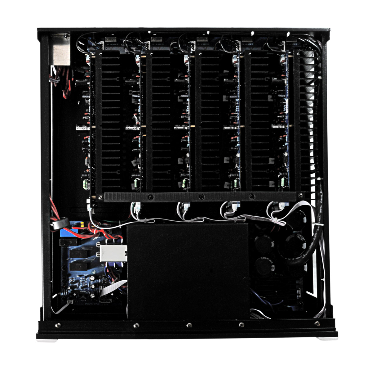

Emotiva XPA-5 AmplifierAre you party animal that likes to crank music at ear bleeding levels to impress your friends and really get everyone moving? If so, you will need a receiver with a hefty power supply - especially if you are running a multi-channel system in a largish room (over 3,000 ft^3). If your speakers are 4-ohm rated and have low sensitivity (<89 dB @ 1 watt), we recommend selecting a more powerful receiver that is rated to handle this. It's usually a safe bet that when buying a THX Ultra2 certified receiver, the power supply is up to the challenge. As a good rule of thumb, if a receiver has some heft to it (40lbs or greater) it will usually be robust enough to pump out some serious power. Onkyo has the lowest priced THX Ultra2 A/V receiver on the market – the TX-SR805 and it has quite a meaty amp section but it lacks some of the bells and whistles of its competitors. If you are looking for a bare bones HDMI-enabled powerhouse, this is a solid recommendation, otherwise expect to pay a little more to get a receiver with better upscaling features and audio streaming.
Bottom line is if you like to listen to music LOUD, don't skimp on power. Alternatively, if it's not in your budget to buy the more powerful receiver, at least choose one with preamp outputs so that down the road you can connect a more powerful external power amplifier. With the price of quality multi-channel amps from the likes of Emotiva (IE. their new XPA-2 and XPA-5 amplifiers) being priced as low as mid level receivers, power has never been more affordable.  Be sure to check out our detailed measurements and analysis sections of our A/V Receiver reviews to see just how well they stack up when being put through our vigorous testing procedures.

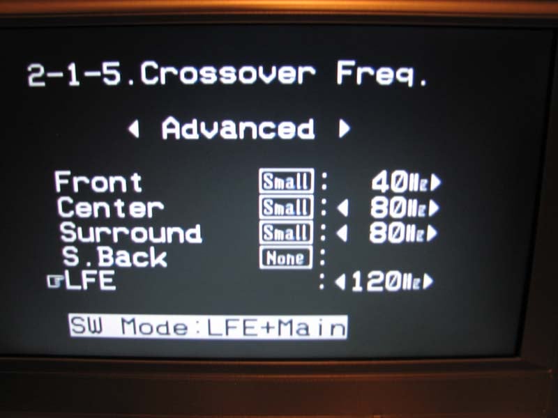

Step 6: Do you need advanced bass management features?
bassIn most cases the typical 80Hz global crossover setting and one subwoofer output will satisfy more users. However, more advanced users will prefer variable crossover settings per channel group and multiple independent subwoofer outputs. For the more advanced user, we suggest digging deeper to ensure that your receiver of choice truly does provide you the flexibility of connecting more than one subwoofer that has independent level and distance trims and will also give you the option of routing LFE and/or bass from all speakers set to 'Small'. There are several processors on the market that simply parallel out the main subwoofer output which limits your setup options. We have found Denon to be the leader in bass management flexibility but lately Yamaha, Onkyo and Marantz are catching up and offering multiple crossover selection per speaker groups, sub out with main speakers set to 'Large', and multiple subwoofer outputs, etc.
