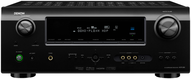

DenonDenon AVR-590 - The Denon is the clear feature winner at this price point. As the only receiver that does any sort of the analogue video upconversion (everything up to HDMI but not scaled), it clearly has an edge on the competition. It is also the second most expensive model at $349 (the AVR-1610 has Speaker B outputs with a few other extras for $399). On top of the upconversion, it also sports full HDMI audio (including all the HD audio formats) and Dolby's ProLogic IIz with height channel analogue outputs. You'll have to add a stereo amp but you'll have the latest toy from Dolby. These outputs can also be used for a pair of surround back speakers. The AVR-590 includes one of the best Audyssey room correction systems - the MultEQ which allows up to 6 positions. Missing is Zone 2 support and multi-channel analogue inputs. iPod compatibility can be added with the purchase of additional hardware.

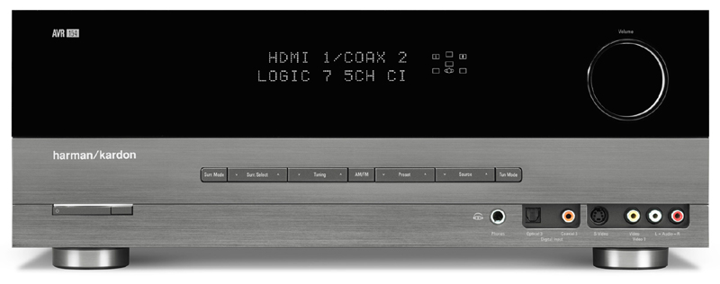

HKHarman Kardon AVR-154 - The HK AVR-154 is the most expensive of all the receivers in this comparison. It is also the only one that doesn't look like a clone of all the others. It completely lacks any sort of auto setup/room correction system, relying completely on the user to do so. It has the most digital audio inputs with three each of coaxial/optical. It includes 5.1 analogue inputs (a good thing) but lacks any sort of video upconversion (even between S-video and composite). There are a number of extras included that are not present on any of the other receivers including Logic 7 decoding (a proprietary DSP mode), Dolby Headphone, front coaxial and optical inputs, and a coaxial output for digital audio (used for recording purposes). One of the features I most like to see at this low of a price point is a crossover setting that can be changed for the different speakers (fronts, center, and surrounds). This is something that you don't see on other receivers until a much higher price point.

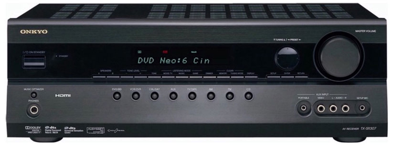

OnkyoOnkyo TX-SR307 - AT $299, the SR307 sits comfortably in the middle of the pack in terms of price. Feature-wise, it comes the closest to the Denon with a slightly less advanced version of Audyssey (2EQ which includes 3 positions) and no video upconversion. For this, though you get a 1.8mm jack for iPod/portable input plus an extra $50 in your pocket. An optional iPod dock, similar to the one the Denon has, is also available for purchase. Of course, "optional" equipment costs extra. The back of the Onkyo is a bit disappointing with spring type terminals for all but the front channels.

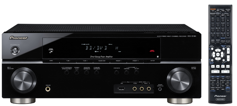

PioPioneer VSX-819H - The 819H is a very new addition to the Pioneer line and is the first to be certified as "iPhone compatible". What this means is that you can plug your iPhone, iPod, or iPod Touch into the USB port and control it via the remote. You can also view album art on the screen as well as album information on the front of the receiver. Some of the other receivers can have this ability but they require additional purchases. Pioneer has never bought into the Audyssey room correction systems and they haven't here as well. MCACC is available but only takes a reading at one position. The VSX-819H has Sirius radio support out of the box (subscription required). The Pioneer is the only receiver that supports DVD-Audio and SACD (2 channel) over HDMI along with HD audio decoding. On top of that, it also sports 5.1 analogue inputs and Zone 2 support (the only one in this category to do so). Clearly, the 819H is geared to your more audiophile crowd. At $299, there is a lot to like here except that is won't upconvert any video signals. Note - Pioneer does offer the VSX-519V for $199. While it is their true entry level, the price was so much less than the rest that it didn't seem fair to compare them. At the price point, however, it has a lot going for it. It has many of the same features as the 819H including 5.1 analogue inputs, MCACC, DVD-Audio and SACD (2 channel) HDMI support (previously unheard of at this price), and Zone 2 pre-outs. In fact, other than a few inputs, the iPhone/iPod functionality, native decoding of the HD audio formats, and the USB port, it is pretty much the same as the 819H. At it's price point, it is a clear leader and in many ways rivals some of the receivers in this comparison.

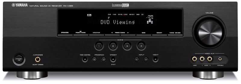

YammyYamaha RX-V365 - The RX-V365 is the least expensive offering of the group but that doesn't mean it doesn't have features in its favor. At $150 less than that most expensive and $100 less than the most featured, you're going to expect some trade-offs. What you will be missing is room correction/auto setup, HD audio decoding, and an HDMI input (it only has 2 where everyone else offers 3). You are still getting 5.1 analogue inputs (a great feature for those with legacy gear) and a 1.8mm input for iPods and portables. iPod and Bluetooth docks are optional and require a additional purchase. Again, we see the dreaded spring type clips for all channels except the mains. While the price is certainly right, you are making a number of sacrifices. Note - Yamaha offers the RX-V465 for an MSRP of $379. It has 4 HDMI inputs, HD audio decoding, and YPAO room correction. While it more closely matches the features and price of some of the other offerings, it is not Yamaha's entry level receiver so was not featured in this article. It is, however, very competitive. The Denon still has it beat on the upconversion (it has none), it lacks the Zone 2 of the Pioneer, and does not have the height channels of other Yamaha's or the 5.1 analogue inputs of some of the other receivers in this price category. Still, something to consider if you are in the price bracket.
