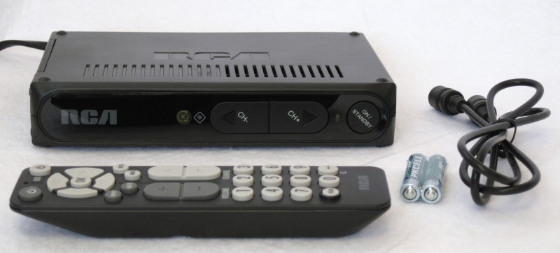

RCA - FullThe RCA DTA800B1 is the lowest cost box in the shootout and is available at Wal-Mart. It was one of the most difficult to acquire as my local stores were sold out for over a month. I believe the cost makes this a very popular option. With a basic black appearance and simple remote control, it is easy for the electronics novice to use. The package includes the tuner, remote, batteries and coax cable. It seemed odd that a simple A/V cable wasn't included as with some of the other tuners. The picture quality seemed acceptable but it lacked some screen format options that would have been useful. Overall, my initial impressions of this box were good for its ease of use.

This tuner is one of the smallest in the shootout and has a side panel that rotates to allow it to stand vertically as well as the usual horizontal position. The front has power and channel plus and minus buttons and a red/green LED for the power status.

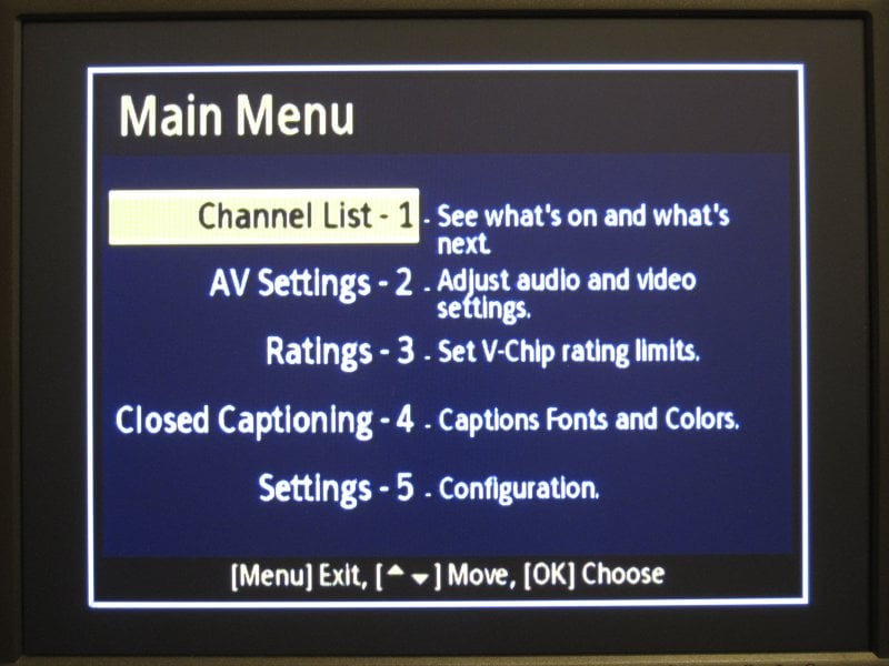

Menu System – 4/5
RCA - MenuThe menu reveals the more obscure settings settings including Power Saver for system inactivity, Time Zone selection, Picture format (full screen or widescreen), Audio format (Stereo or Alternate), and a System Reset. It seems that the designers assumed that this tuner will only be used with a 4:3 TV screen as no other picture formats were available. The main menu was simple and included the Channel list, AV Settings which were just mentioned, Ratings for V-Chip control, Closed Captioning, and Settings to control other system options. It was awkward to bring up the menu to get to some of these items, especially the screen format, but the menu was numbered and easy to read and the process became quicker after some repetition.

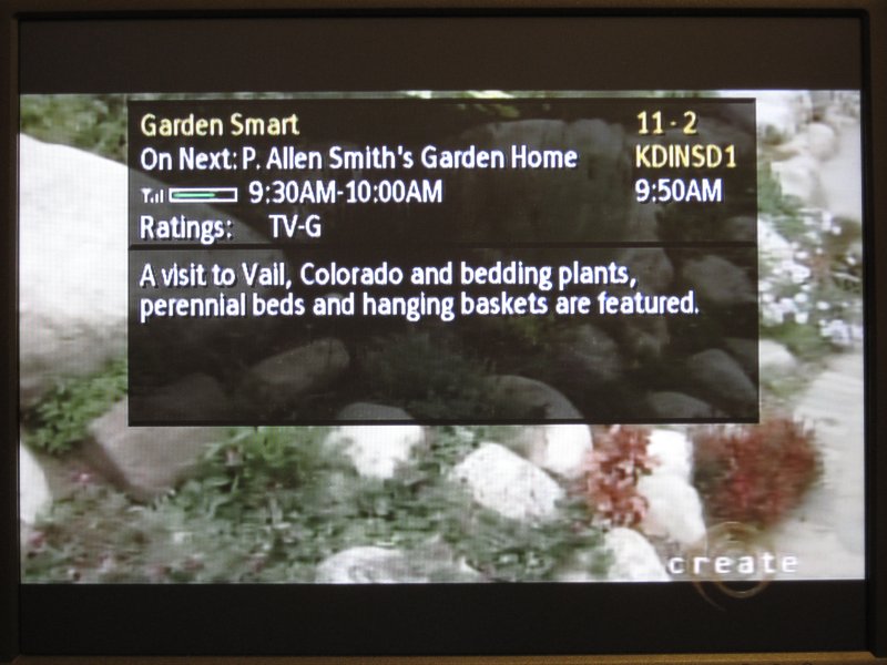

Channel Information – 5/5
RCA - Channel InfoThe Info button brought up a very nice, semi-translucent info screen with a lot of information. The Program Title, name of next program, signal meter, time range for current show, rating, channel number and call sign, and the current time were all included. An additional click of the Info button added a text window with the full program description. Everything was easy to read and not distracting from the actual video material behind it.

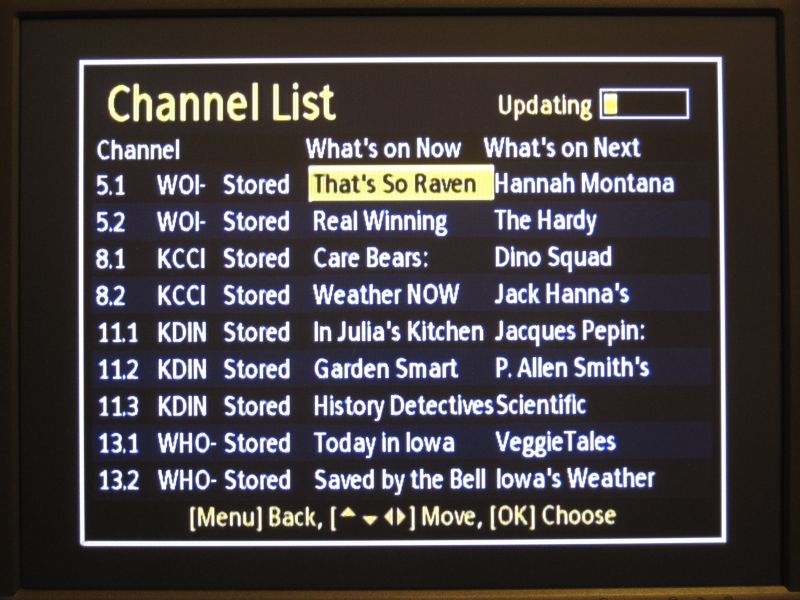

Program Guide – 3/5
RCA - GuideAs there wasn't a Guide button, this information was only accessible through the main menu. The Channel List, as it was called, brought up a simple list of channels, the current program on each, and the next program coming up. It constantly rescanned the channels so it was always up to date. However, times for the programs were missing and you couldn't get extra info on the program unless you tuned to the channel first. The table structure was easy to read, but only provided basic information and could have been better.
