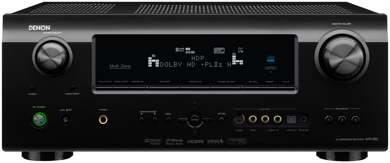

Denon.jpgDenon AVR-890 - The Denon AVR-890 ties for the most expensive in the comparison at $799. For that money you get many of the same things you've gotten in their cheaper offerings including Audyssey MultEQ, 1080p upconversion via HDMI, Sirius ready, and 7.1 channel analogue inputs. Of course, you are getting more power (105 watts versus 90) and an additional HDMI input (five - the most of any receiver in the comparison). Video upconversion includes component this time around, making integration of legacy equipment easier. Plus, they've included a Phono input showing vinyl aficionados a little love. Also, while Anchor Bay was specified in the $500 offering, this time they specify the ABT-2010 chipset which we know has top tier performance in video upconversion. Disappointingly, there are a few deficiencies. Most notably is the lack of a multi-channel output. If you aren't looking to upgrade to external amplification this may not be important to you. It does, however, seem to be a pretty glaring omission at this price point.

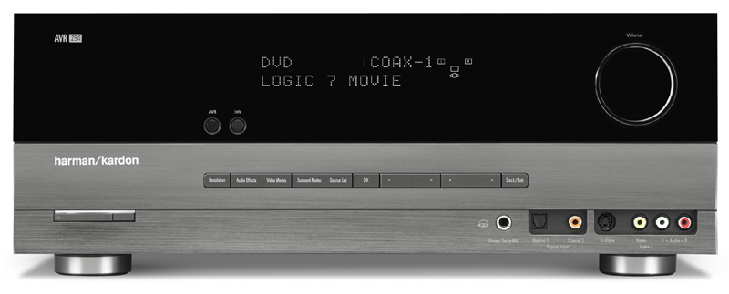

HarmonHarman Kardon AVR 254 - The AVR 254 is one of the least expensive receivers in this comparison at $649. Harman is famous for rating their receiver's power differently from everyone else so there is no way (other than a test bench) of knowing how the AVR 254's 50 watts compares with everyone else's ~100 watts. The AVR 254 has much of what you'd expect at this price point including HDMI and component video upconversion (including 1080p upconversion via HDMI), dual zones, mini jack for iPod/MP3 players, and an automatic room correction system. The Auto EQ is dubbed EzSet/EQ and seems to be limited to one position. The AVR 254 has 7.1 analogue inputs and preamp outputs plus a host of other connection types. With only three HDMI inputs, it ties for the second lowest number in the comparison. This is something to consider if you have (or think you might have) a lot of video sources. The video upconversion is handled by Faroudja DCDi which has adequate if not stellar performance. There is an RS-232 port, but it seems to be limited to firmware upgrades and not meant for home integration control.

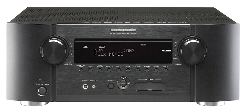

Marantz.jpgMarantz SR5003 - The Marantz SR5003 is actually due to be replaced soon by the SR5004. It is still a fairly new receiver and so we decided to keep it in the comparison. It still competes well with 1080p video upscaling via HDMI, HDMI and component video upconversion performed by an i-Chips Technology chipset, and 7.1 analogue inputs and preamp outputs. The look and build quality of the Marantz is a bit higher class with an all aluminum and slightly convex faceplate. Like the HK, it only sports 3 HDMI inputs which may be a bit limiting. If you want to wait for the next model to come out, it may have more (unknown at this time). The SR5003 retails for $799 tying it for the most expensive in the comparison. It is XM and Sirius ready and is one of the two to support a third Zone. While you can use the internal amps or analogue pre-outs for Zone 2, Zone 3 is only supported via a digital optical output requiring a separate receiver or other DAC capable device.

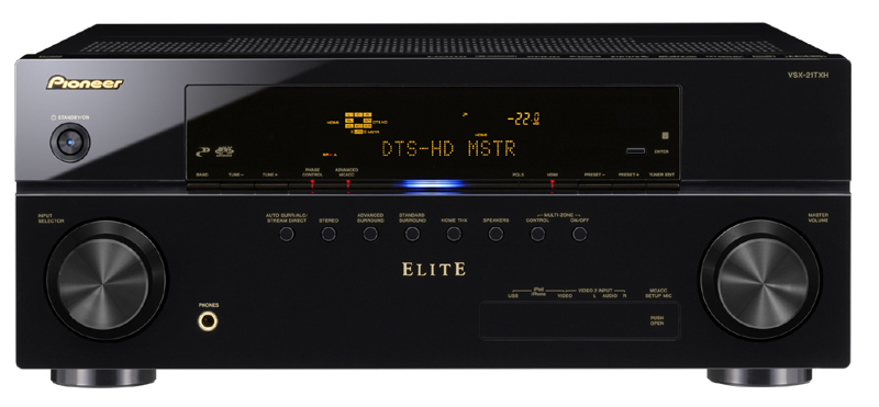

PioneerPioneer Elite VSX-21TXH - The Pioneer Elite VSX-21TXH is the entry level in the Elite line. It retails for $699. You'll recognize many of the features including the Made for iPhone certification providing the only out-of-the-box iPod/iPhone support of any receiver in the comparison. This feature continues to give the Pioneer lineup a distinct edge. Even if you aren't an iPod user, the USB port supports all the major video/music formats so you may not want to dismiss it out of hand. The 21TXH has 4 HDMI inputs, HDMI upscaling to 1080p, HDMI and component video upconversion, and is the only receiver that truly supports three zones ALONG WITH composite video (no one else is even contemplating this at this price point). This is the first receiver to introduce Pioneer's new PQLS (precision quartz lock system) which slaves the clock on the Pioneer Blu-ray player and the receiver to reduce jitter. This offering is only two channel though you'll see better systems on the more expensive offerings. The VSX-21TXH is also the only receiver in the comparison that is THX certified, bearing the THX Select 2 level. The MCACC room calibration is still only three positions which doesn't really compare with the MultEQ of the Denon and Marantz. Most disappointingly, the VSX-21TXH only supports 5.1 analogue inputs (though it has 7.1 analogue outputs). While you can make an argument that with HDMI you'd never need more than 5.1, we'd disagree and can think of a number of pieces of legacy gear that would use it. Lastly, it seems that Pioneer is continuing to focus on the audio side with Burr Brown and Wolfson DACs and ADCs.

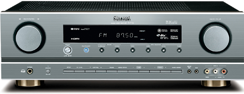

Sherwood.jpgSherwood Newcastle R-772 - The Sherwood Newcastle R-772 was included to show what some of the lesser known brands are offering - and that is not much. While you can make the argument that the lack of features somehow suggests less processing of the signal, you could just buy an older receiver of the other brands (or engage the ubiquitous Direct or Pure Direct modes) for the same effect. The R-772 will decode all the HD audio formats but only includes 2 HDMI inputs, no video upscaling of HDMI upconversion, and no multichannel pre-outs. The R-772 does have 7.1 analogue inputs and one position automatic room correction however. But that's not to say that it doesn't have anything to offer that is new. The remote is IR and RF, which may be useful for hiding your gear. There is an RS-232 port for home integration installation and a USB port for firmware upgrades. Probably most unexpectedly, the R-722 allows you to switch your amps on the fly so you can connect both your Surround Backs and Zone 2 speakers. This could be a huge bonus for those that want to run a full 7.1 system and a Zone 2 but don't want to buy the extra amps or switch wires manually.

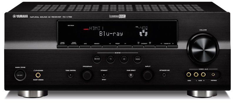

YammyYamaha RX-V765 - The Yamaha RX-V765 is the only receiver in the bunch with dual mono subwoofer outputs (something we hope to see others adopt in the future) and ties for the least expensive at $649. It has 1080p upscaling but still lacks analogue video upconversion to component or S-video (you can only upconvert analogue sources to HDMI). There is a mini jack on the front for portable integration like an MP3 player but no iPod support without an optional dock. The RX-V765 is also compatible with the Bluetooth dock offered by Yamaha. What Yamaha really has going for it here is its price. At the lowest in this bracket, you get the bare bones of what you need plus some stuff that you might not. You may not get iPod support or Audyssey MultEQ, but you do get 7.2 analogue pre-outs and a ton of DSP (Digital Signal Processing) programs.
