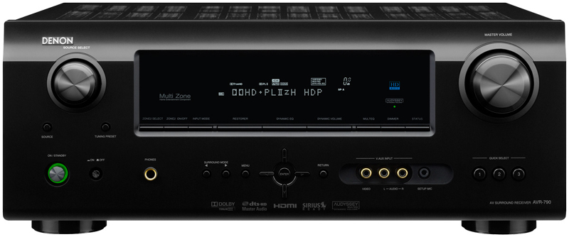

Denon.jpgDenon AVR-790 - Again the Denon leads in features with the AVR-790 but surprisingly, they fall a bit behind in some ways. The huge boon for Denon is the Anchor Bay Technologies VRS upscaling via HDMI. Anchor Bay is known for high quality upscaling (we've seen VRS give perfect scores on the HQV test) and inclusion at the $499 price point is quite a coup. Most of the features are pretty universal across all the receivers such as number and types of connection, HD audio decoding, HDMI upconversion, and Zone 2 (audio only) support. Again, Denon has Dolby ProLogic IIz but at least this time they are not alone. They still lead the pack with Audyssey MultiEQs 6 position room correction system. The receiver is Sirius ready (no dock required) and has a digital optical output. The real glaring omission on te AVR-790 is the lack of multichannel pre-outs. This completely hamstrings this receivers ability to be upgraded with external amplification. If they had pre-outs, this would be the no brainer choice for enthusiasts looking for top notch upscaling with a perchance to add external amplification. Note - Denon offers an AVR-1910 for $50 more with enhanced power amp assignability (which is code for B speakers from what I can tell). There may be additional features but they don't seem to be very prominent or important enough to Denon to mention it.

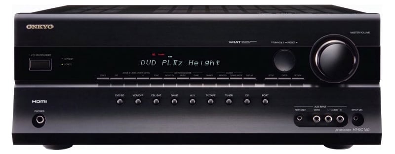

Onkyo.jpgOnkyo HT-RC160 - The Onkyo HT-RC160 one of the two receivers in this lineup with dual subwoofer outputs. It is also ties the other 7.2 receiver as the most expensive at $549. As huge proponents of running multiple subs, we love to see this feature even if it really just dual mono output. Stereo sub outputs would be much preferred but that feature hasn't trickled down yet. The RC160 is the only receiver to break out of the 4 HDMI input with one extra. They have Faroudja DCDi upscaling but it is only to 1080i (according to the manual - the press material is markedly mum about it). This is not a huge problem but we know from experience that DCDi tops out at 90 or less on the HQV test which is well below what Anchor Bay can deliver. Onkyo also sports Dolby ProLogic IIz, a powered Zone 2 (with dedicated terminals which means you can switch on the fly without having to rewire your system), Audyssey 2EQ (3 positions), and a mini-jack for portables. The real surprise here is that Onkyo has neither mulitchannel inputs nor outputs. We've discussed with the Denon the importance of the outputs but inputs help make a receiver future-proof. When HD audio arrived, you could purchase a player with multichannel outputs to take advantage of the new formats without having to upgrade to an HDMI capable receiver. With the Onkyo, you'd be stuck. The RC160 is the only receiver that has a HD Radio tuner add on for an additional cost.

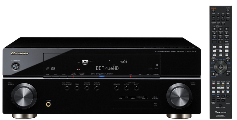

Pio.jpgPioneer VSX-1019H-K - The Pioneer VSX-1019H-K matches the price of the Denon but seems to have different priorities. While they have 1080p upscaling, it is some proprietary version that surely won't score as well as Anchor Bay and maybe not even as well as DCDi. What they do have, however, is conversion to any video output. While HDCP won't allow HDMI downconversion, all analogue outputs are sent to all outputs. This may really help those with a legacy TV or a bunch of legacy gear. MCACC room correction is available with up to 3 positions. Made for iPhone is again available making the 1019H-K ("K" by the way means that it has Kuro Link allowing HDMI CEC control of similarly equipped Pioneer gear) the only iPod friendly out of the box receiver in the lineup. What is very cool about the 1019H is that is has a composite video output for Zone 2. This is the only receiver in the group (and probably won't see competition for a while) with video to Zone 2. The shock (and I do mean shock) is that not only are there no multichannel outputs, but inputs are limited to 5.1. While this is better than nothing, it is a bit mystifying considering how audio-focused Pioneer seemed to be with their last offering. The 1019H is also Sirius ready out of the box so you won't need an additional purchase. Again, the Pioneer is the only one with a USB port and support for music and pictures.

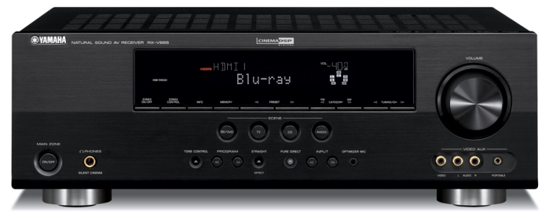

RX665.jpgYamaha RX-V665 - The Yamaha RX-V665 is tied with Onkyo as the most expensive offering (only $50 over the two lower ones) in the lineup at $549. The other receiver that has dual subwoofer outs, the V665 sports 1080p upconversion (Faroudja DCDi like the Onkyo), a full compliment of analogue inputs and outputs (7.1/7.2), and Zone 2 support. There, however, the Yamaha ends. There is no component video upconversion, iPod and Bluetooth support requires additional purchases, and the YPAO is the most limited (1 position only) of the group. The receiver is XM and Sirius ready out of the box and sports a mini jack for portable connectivity. While it may not have all the bells and whistles of some of the others, it does have a lower price and a no-frills approach on its side. Yamaha is also known for their DSP modes and the V665 doesn't disappoint with 17.
