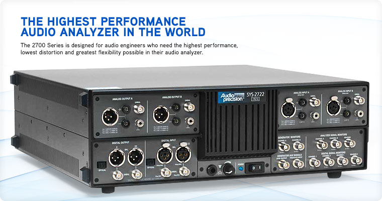

AP SYS2722For the past 5 years the AP 2700 ~$25K Audio Analyzer was the center piece of our reference test equipment, empowering us to do the industry's most comprehensive measurements of audio amplifiers and A/V receivers. The only downside of this unit was its complexity. Walking away from it for a few months and coming back was, in kind words, an uncomfortable experience. Suffering through the trials of getting it to do what I wanted all the time was like trying to ignore a bad tooth ache. Don’t get me wrong, this is still the industry's finest Audio Analyzer and a design engineer's dream machine. But it’s not speedy for a neophyte or casual user to operate and its automation process leaves much to be desired in my book. Granted, as a former telecommunications engineer, I was quite familiar with their System One, Two and this unit all of which operated in similar platforms. So I wasn’t just a casual user of these devices.

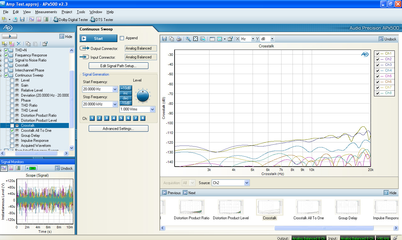

xtalkAdvanced Crosstalk Testing
Instead of only looking at pair to pair crosstalk between channels, we will be testing worse case scenarios (Crosstalk All to One) where all but the channel under test will be the noise source while we measure the bleed over to that channel under test.
