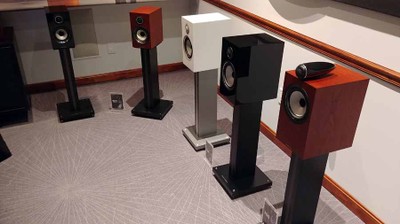

Bookshelf Models
B&W 705 S2The lineup contains three ported bookshelf speakers beginning with the 707 S2 ($1,200/pr) which is a compact 2-way bookshelf speaker featuring a 5" midbass driver and 1" dome tweeter, 8-ohm nominal impedance, a -3dB points of 50Hz and 28kHz and sensitivity of 84dB at 1 meter/2.83V and recommended amplifier power of 30 - 100 watts.  It's pretty hefty at 13lbs for such a small cabinet enclosure 11" x 6.5" x 11" (HxWxD).
Next up is the 706 S2 ($1,800/pr) which steps you up to a 6.5" woofer for increased sensitivity of 88dB at 1 meter/2.83V but maintains a similar low frequency -3dB pt to its smaller sibling, which seemed a bit odd initially considering they did sound bassier to us in comparative listening tests.  While the -3dB points appear to be very similar between the two models, the 706s had a greater sense of perceived bass  because of their larger drive unit/cabinet combination and higher sensitivity making them more linear at bass frequencies. With a bigger woofer comes a bigger and heavier enclosure measuring 13" x 8" x 12" and weighing 17lbs.
The 705 S2 ($2,500/pr) is the top bookshelf speaker in the series, identical in driver compliment and output to the 706 model but it places the tweeter on top of the cabinet in its own isolated and decoupled chamber for a more refined and open soundstage.
A bookshelf speaker needs a great stand to provide a solid foundation and proper acoustical height of the speaker with respect to the listener. The FS-700 S2 ($250/ea) is such a stand.  While it doesn't come cheap, it is built incredibly well and is very inert when sand-loaded and it looks great to boot. It's the ideal speaker stand for use with 707 S2, 706 S2 and 705 S2, models and is available in Black or Silver finishes. Incidentally, when the 705 S2 is mounted on these stands, the tweeters are at the same height as the 702 S2 floorstanding model, which was a deliberate and intelligent design consideration by B&W. Attention to detail counts for a lot.

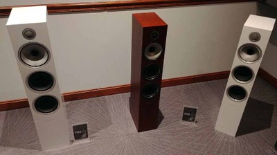

Floorstanding Models
B&W 702 S2The 700 S2 series offers three ported floorstanding models with the first in the series being the 704 S2 ($2,500/pr).  The 704 S2 is a four driver, 3-way design with dual 5" bass drivers, one 5" midrange and 1" dome tweeter. The speaker is rated at 8 ohms, with a sensitivity rating of 88dB at 1 meter/2.83V and a -3dB points of 48Hz, and 28kHz, with a recommended amplifier of 30-150 watts.  It's a rather slim tower measuring 38" x 10" x 12" (with plinth) and weighing 41 lbs.  With the same retail price as the 705 S2, one has to really ponder should they opt for a tower or the best bookshelf in the series.  The answer depends on how you plan on using the speakers.  If you're running a system with powered subs, then the 705 S2 bookshelf on stands may be the way to go.  If, however, you're running a dedicated two-channel system in a medium-sized room, then the 704 S2 is your ticket.
If you want more output, more bass, and more sensitivity, than look hard at the 703 S2 ($3,500/pr).  The 703 S2 has the same number of drivers as the 704 S2 model but the bass and midrange drivers are each upsized to 6.5" and 6" respectively.  The cabinet volume is increased by about 53% measuring 40" x 12.6" x 14.6" (with Plinth) weighing 55.2 lbs. The speaker is rated at 8 ohms, with a sensitivity rating of 89dB at 1 meter/2.83V and a -3dB points of 46Hz and a recommended amplifier power of 30-200 watts.
Finally, the flagship model 702 S2 ($4,500/pr) sports the same driver compliment of the 703 S2 but places the tweeter on top of the cabinet in its own isolated and decoupled chamber for a more refined and open soundstage.  Crossover components are upgraded and the cabinet is slightly deeper (13.3" vs 11.8" of 703 S2) allowing for a deeper bass extension of 45 Hz and a higher sensitivity rating of 90dB at 1 meter/2.83V with a recommended power amplifier usage of 30-300 watts.

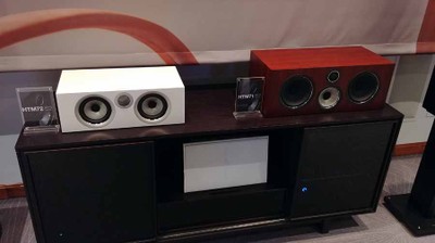

Center Channel Speakers
B&W offers two center channel speakers in the 700 S2 series.  Both models employ similar drive technology and are sonically matched to the rest of the 700 S2 lineup.
The HTM72 S2 ($800/ea) is a 2-way, 3-driver design with dual 5" midbass drivers, and 1" dome tweeter in a MTM configuration with a raised tweeter to improve off-axis performance.  The speaker is rated at 8 ohms, with a sensitivity rating of 87dB at 1 meter/2.83V and a -3dB points of 70Hz and 29kHz and a recommended amplifier power of 30-120 watts.  It's a compact center channel speaker measuring 18.9" x 6.6" x 10.8" (WxHxD) and weighing a hefty 20.1 lbs.
B&W HTM71/72 S2
B&W HTM72 S2 (left pic) and HTM71 S2 (right pic) Center Channels
The HTM71 S2 ($1,350/ea) is a 3-way, 4-driver design with dual 6.5" bass drivers, 5" midrange, and 1" dome tweeter in a W(T/M)W configuration for optimized on and off-axis performance.  The speaker is rated at 8 ohms, with a sensitivity rating of 89dB at 1 meter/2.83V and a -3dB points of 50Hz and 28kHz, and a recommended amplifier power of 30-200 watts.  It's relatively large center channel speaker, measuring 23.2" x 8.6" x 12" (WxHxD) and weighing a whopping 39.7 lbs.
For smaller installations utilizing 700 S2 bookshelf speakers as main left/right speakers, the HTM72 S2 is the ideal solution.  For larger installs where 700 S2 towers are utilized in rooms with wide seating area, the HTM71 S2 is the better choice for wider coverage and more output. In addition, the HTM71 S2 matches the driver compliment of the 703 and 702 S2 models for the most ideal acoustical blend.

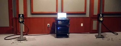

Listening Tests Results
Andy Kerr took us into a dedicated demo room that was fitted for immersive surround sound (with discrete height speakers, no bouncy house reflection kind).  However, the focus of our demos was two-channel, particularly the improvements the new 700 Series 2 have over the comparable outgoing CM models.
B&W CM vs 700 S2 Demo
We started off with entry level models from both series, specifically the 707s vs the old CM1s.  The sensitivity of comparable models was similar so the levels were well matched when switching between speakers. This wasn't a blind test or even an instantaneous switch over between the two models. However, in my experience I've always found if differences were significant enough between audio stimuli and the comparison switch times is relatively short enough, the listener can usually discern differences with a good degree of accuracy.  If this wasn't the case, how could one compare driving dynamics between two cars or the palatability between burgers from two different restaurants?
