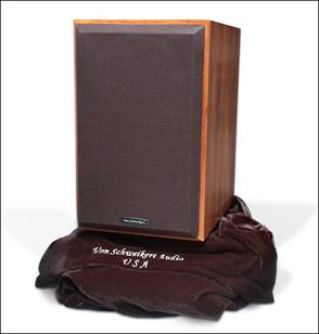

All speakers were doubled boxed and packaged very well. Once inside the second box, we found a plastic wrap around a black velvet wrap which encased each speaker. The black velvet wrapper was embroidered with Von Schweikert Audio USA logo and knotted on top with a tight rope. At first, I questioned such elaborate packaging, but after pondering on it, I recognized that it's all part of the attention to detail that we've found throughout Von Schweikert's speaker line. To me it also showed that Albert Von Schweikert really cared about how he presented his name while recognizing the importance of a first impression. The velvet bagging also came in handy when we traveled to different locations and implemented the speakers on different reference systems as it made them easier to carry around while also protecting the beautiful finish.

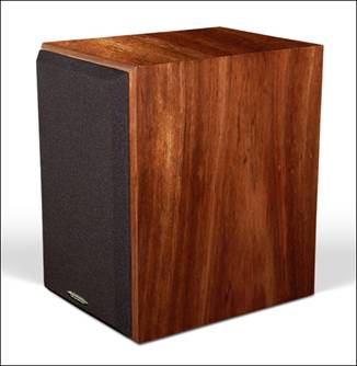

I have to say that Von Schweikert Audio VR-1's, VR-2's, LCR-15 and VR-S/1 sub had remarkable wood veneer finishes. The speakers we reviewed were finished off in a beautiful African Hazelwood veneer. The only other wood tone that I've found to match their beauty was in my Carver and Guitar Factor guitars. Albert told us that they even go out of their way to pay extra for the veneers to assure that the grain structure match for each pair. Von Schweikert offered several different finishes, including Maple, Red Cherry and Black, but what's interesting is that they do not charge extra for any selection. The other redeeming quality we recognized about the speakers was that the bottom and back of the cabinets were also finished with matching veneer. The finishes assured that not only did we receive a quality looking product, but the speakers would likely breeze through the Wife Acceptance Factor (WAF) .
African
Hazelwood
Maple
Red Cherry
Black
Build Quality - Edges
But Von Schweikert didn't stop at just the veneer finish. In addition to finishing the entire enclosure, the speakers also came with chamfered edges around the front perimeter, forming a compound angle in the corners. Once again, even the bottom-front of the speakers were finished with this chamfer, indicating that this company paid attention to detail and craftsmanship. Additionally, both the woofer and tweeters were fully recessed into the cabinets given a more uniform look while also minimizing the potential of unwanted refraction.bindingposts.jpg

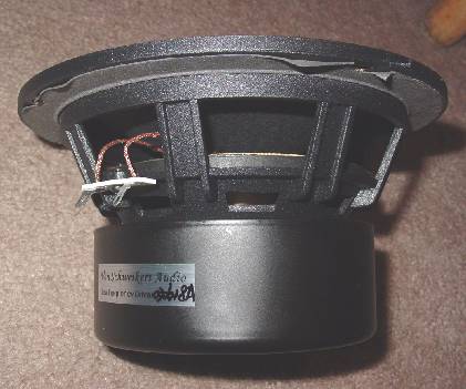

Von Schweikert incorporated what they call a VSA Low Distortion Motor system
including a 6.5" resin impregnated mica/cellulose composite cone, cast metal frame (unusual in this price class), high temperature voice coil, and large shielded magnet. The build quality of this driver aroused our expectations of this speaker, which was quickly satisfied once we listened to their stellar performance. Most speakers in this price range offer a lesser quality driver basket motor structure such as stamped metal or plastic molding. A cast basket had advantages in terms of strength, reduced resonance, and non magnetic properties that ensured the potential of the magnet was not compromised.

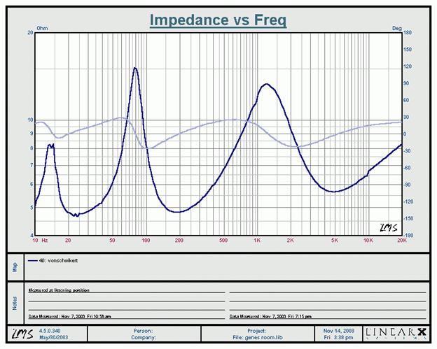

Performance Curves of VR-1
Dark Blue - Impedance Curve: Min impedance is about 4.75 ohms between 150-200 Hz, with a peak of 15 ohms at 70 Hz (around the bass limits of the speaker). Due to the relatively small port and low tuning frequency of around 30 HZ , there is really no usable/audible contribution from the port. Instead, the port acts to limit driver excursion at very low frequencies and increase dynamic range of the speaker. The rising impedance of the speaker starting at around 7kHz exhibits inductive loading.
Light Blue - Electrical Phase Plot: The VR-1 bookshelf speakers have good phase response as indicated by ± 30 degree window it maintains within the entire audio spectrum above 70 Hz. In addition the moderately high sensitivity (89dB SPL @1 watt/meter) and lowest impedance dip of 4.75 ohms indicates pretty much any decent solid state amp should be able to drive these speakers without incident. However, we suspect an amplifier with the lowest possible output impedance would be beneficial due to the reactive nature of the impedance curve to minimize any possible frequency variations.

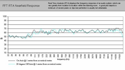

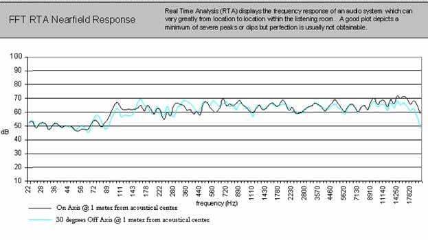

VR-1 Near Field Frequency Response
The VR-1 bookshelf's (or Reference Studio Monitors as the Manufacturer classifies them) were placed on 30" stands at least 6 feet away from all walls in a well damped room with carpeted floors and flat ceilings. The on axis response (black) indicated a slight emphasis on high frequencies above 10 kHz. The 30 degree off axis response (cyan) helped to smooth the overall response of the speaker indicating that this speaker may perform better with minimal toe in, especially in lively rooms.
