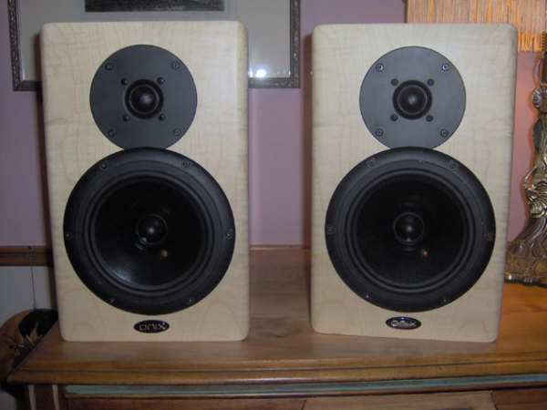

When the X-LS arrived I was a bit surprised at the size of the shipping container: It seemed large for something housing a pair of 2-way bookshelf speakers. Popping the thing open I found packed within the outer container a second container and inside that were located the speakers. Size mystery solved. This packing approach is a great way to ensure your system arrives intact and in working order.
Each speaker, wrapped in a plastic cover and well protected by the container-within-a-container, arrived unscathed and ready to rock. Accessory-wise, the package included spikes that can be bolted into the base of each cabinet, should you feel the need to use them. Along with the spikes are supplied discs for use with the spikes, should you need to avoid poking holes in whatever you have the speakers perched on. The speakers did not come equipped with grill clothes and provided for no means to attach one. Cable attachment is accomplished with the usual 5-way binding posts.
A bit about the cabinet. The shipping documents indicated the finish was white maple and indeed it was. The white maple veneer is banded across the cabinet in a clever and aesthetically pleasing way that I've not seen done before. It all adds up to an intriguingly attractive product that would look good in a variety of decorating schemes.

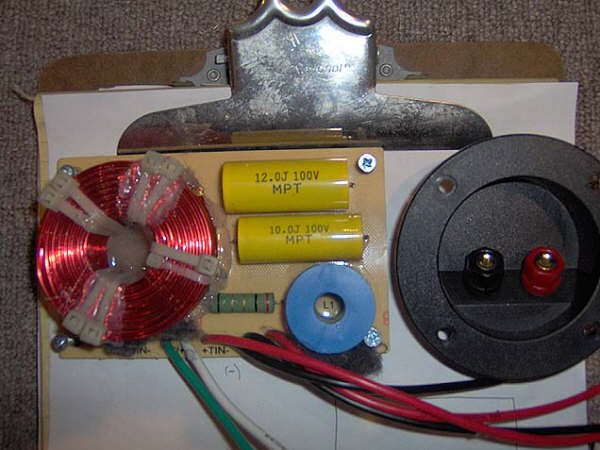

The crossover network is positioned at the front end of the cabinet's bottom panel. All components are tie-wrapped and/or glued to the circuit board. All connections are soldered and 12 AWG wire is used throughout. This is rare in speakers at any price since most use 14-16AWG. Impressive for a 199/pr of speakers!

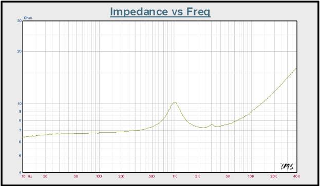

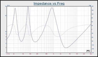

The tweeter used is a convex soft-dome unit, featuring a 25.4 mm voice coil, fully shielded and sporting a damped rear chamber.
Free air resonance is 1kHz and sensitivity clocks in at about 96 dB. Nonlinear distortion tests showed this to be exceptionally clean for a driver in this price range.

Figure 1: x-ls Tweeter Impedance Curve

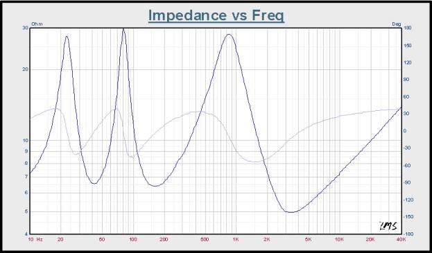

Figure 2: x-ls Impedance Curve
The impedance minimum 0f 6.56 ohms at 42 Hz indicates the vented box tuning frequency. There are two other local minima, found at 164 Hz (6.386 ohms) and 3.4 kHz (4.97 ohms). That the first two minima are proximal in magnitude indicates an efficient reflex action. The large impedance peak, found at ~ 850 Hz arises as a result the interaction of the crossover network's high- and lowpass sections, setting up a parallel resonance.
The impedance phase swings between +39° and -54° across the audible spectrum. With a lowest magnitude minima value of 4.97 ohms, the system nominal impedance (per IEC standards) value would be 6 ohms. Overall, the x-ls will present whatever amp that sits upstream of it a relatively benign load.
Impedance curves are useful in diagnosing pathologies such as pronounced mechanical resonances, defective drive units, etc. In this impedance curve we see no tell-tale symptoms indicating underlying pathologies.

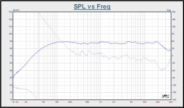

Figure 3: xl-s system amplitude response, scaled to 1m, 2.828 Vac drive level.
Figure 3 shows the x-ls full-range frequency response, obtained by combining a 1m, on-axis gated response with a nearfield woofer & port response, appropriately summed and scaled. System sensitivity averages 87.5 dB in the 300 - 3000 Hz segment of the system's passband, an average value for a system of this type. The data is 1/12 octave smoothed.
Relative to the 87.5 dB sensitivity value the low frequency, -3dB point is 60 Hz. The high frequency -3dB point is about 23 kHz. (Note: the slight up tick in response seen at 35 kHz and above is the result of the measurement microphone detecting the acoustic output of a motion detection security system that happened to be operating in the vicinity at the time of measurement. It's not a system-sourced pathology). Across the 60 Hz - 23 kHz passband, system response varies by ± 1.8 dB. Excellent!

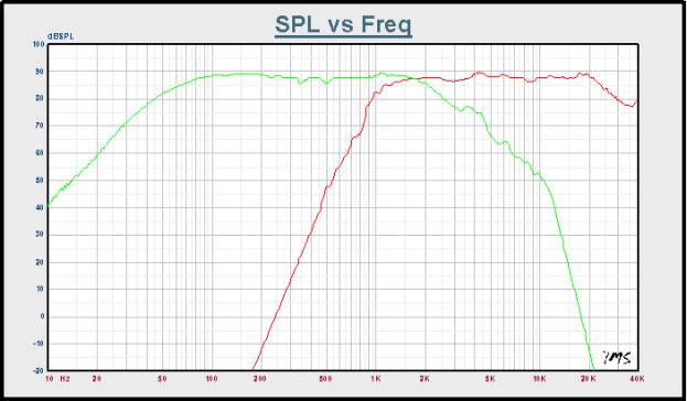

Figure 4: xl-s acoustic crossover frequency measurement, fxover @ 1.7 kHz
The acoustic crossover frequency was determined to be approximately 1.7 kHz (Figure 4) by measuring the on-axis response of the woofer & tweeter, separately.

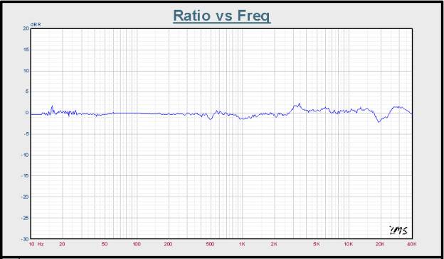

Figure 5: x-ls, system A & B amplitude response match comparison.
The x-ls pair were well matched acoustically and electrically for speakers in this price range, as indicated in figure (Figure 5) and (Figure 6), never straying more than ~ ± 2 dB across the audible spectrum. A good match, such as this, is indicative of a system capable of stable imaging.

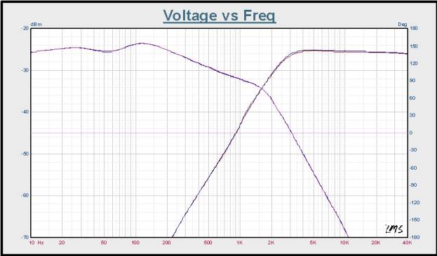

Figure 6: Voltage transfer function of each filter when it is loaded by its driver, both systems.

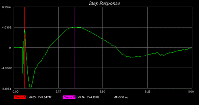

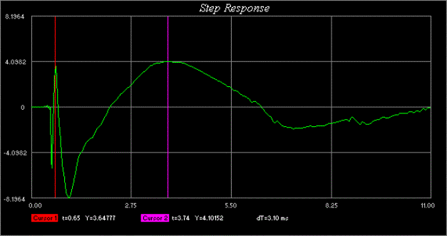

In Figure 7, we see the acoustic step response of the system. The woofer peak occurs some 3.10 ms behind that of the tweeter, as measured at the microphone position. We also see the typically fast tweeter rise time and the much slower rise time of the woofer. The system is not time coherent.
Only modest weight is given to this measurement as the presence of so many other acoustical artifacts tend to swamp the subtle effects of the time difference as shown in figure 7.
Figure 7: x-ls system step response
