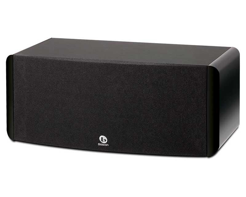

A225C Design
Inline with the physical attractiveness of the rest of Boston Acoustics A-Series loudspeakers, the A225C compliments with a capable center channel occupying a rather shallow 8 7/8” depth with a 16” wide by 6 5/16” high façade.  A curved magnetic speaker cover hides the entire front of the center channel giving it that familiar center channel look.  The top is covered with the black leather textured hardboard material with piano black side panels. The center channel blends in and looks like it belongs without much strife.
The rather small cabinet is constructed out of medium density fiberboard and has adequate material thickness on all panels for a solid feeling center channel at 15.4 pounds.  The material selection and drivers are a perfect compliment to Boston Acoustics’ other A-Series speakers such as the A360 floorstanding loudspeaker.  The cabinet is ported with a tuning frequency of approximately 65Hz.

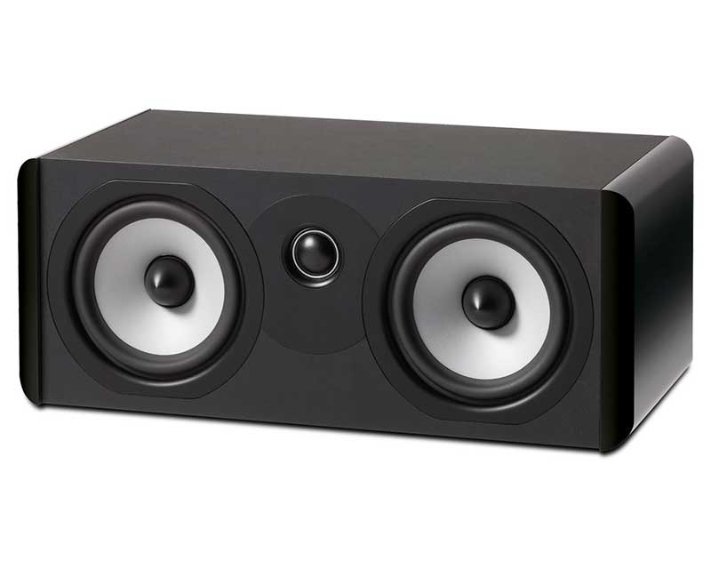

Boston Acoustics A22C Without Grille
A225C Driver Configuration
The A225C is the standard center channel configuration with a tweeter between two mid-woofer drivers (aka. MTM).  In this case, the tweeter is slightly offset favoring the top of the cabinet.  The 5 ¼“ woofers are made from a ceramic and glass fiber polymer.  The drivers feature deep channel design technology providing the drivers more travel space before bottoming out. The woofers have a black dust cap that looks like a phase-plug but are glued to the cone material.  The tweeter is the same 1” Kortec soft dome tweeter found in the A-series speakers.  The center channel crossover frequency is 2.6kHz.  The A225C features good quality 5-way binding posts in a standard terminal cup.  If you plan on using a banana plug, use a small flathead screwdriver to remove the black and red plug inserts in the 5-way binding posts.

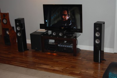

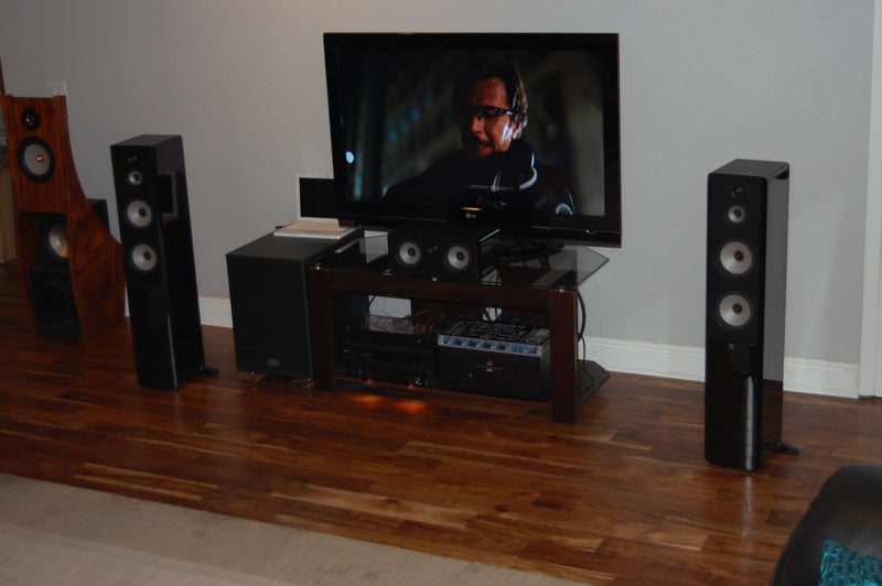

For the listening tests in this review, I moved the A225C into my main listening rig.  The Boston Acoustics A360 floorstanding loudspeakers were reviewed at the same time and used as the left and right channels.  A HSU VTF-3 MKII subwoofer and in-ceiling JBL surround speakers round out the multi-channel system.  The A225C was connected to an available channel of an ATI AT6012 amplifier.  The amplifier was connected directly to the venerable Oppo BDP-105 source using unbalanced connections.  The volume control in the BDP-105 was used for all listening tests.  Prior to listening tests, each channel except the sub was level matched to within 1dB A-weighted from the listening position using pink noise and a calibrated SPL meter.  For level matching the subwoofer, pink noise was compared between the A360s and subwoofer using 63Hz octave weighting on the SPL meter with the A360s run full range.  All listening tests were run full-range on all channels for music and with a 60Hz high-pass filter for movies.
Boston Acoustics Home Theater System
Listening Environment
Sound Quality
The listening room is approximately 24’ by 20’ and consists of hardwood floors throughout.  There is a 12’ by 10’ area rug with thick carpet padding between the loudspeakers and the listening area.  The center channel was setup on top of the entertainment center as it would be in most homes.  The listening distance was approximately 12 feet directly on axis with the center channel.

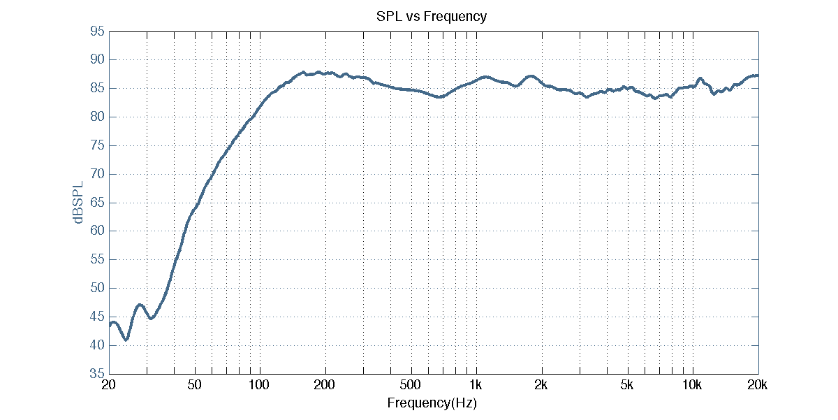

A225C spl_out
A225C On-Axis Frequency Response
The on-axis frequency response of the A225C was conducted with the measurement microphone at 1 meter with a 2.83V excitation signal. The manufacturer rates this loudspeaker’s sensitivity as 89dB at 1 meter with a 2.8V input.  Audioholics measures sensitivity as the average SPL from 300 to 3kHz.  The A225C Audioholics rated sensitivity is below the manufacturers rating at 85.4dB. The manufacturer may have rated the A225C’s sensitivity in room.  The measurement technique used above involves removing all of the effects of a room.  The A225C response looks relatively linear but has a -3dB point of 102Hz with a steep 18dB/octave roll off.  Due to the slight bump at 200Hz, the speaker still sounds warm.

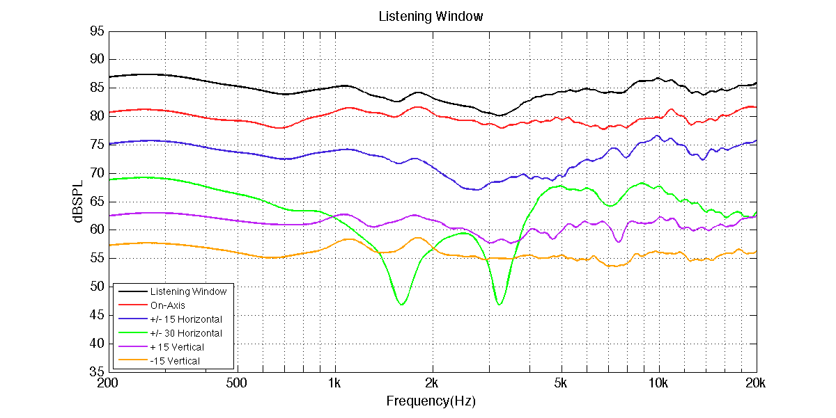

A225C listening window
A225C Listening Window
The listening window response of the A225C is pretty uniform except for at 30 degrees off axis.  The huge nulls in the frequency response are due to the midrange-tweeter-midrange (M-T-M) configuration lobing error. This is one of the reasons horizontal center channels with a MTM configuration present a compromise when listening far off-axis. To confirm something else was not happening, I measured this phenomenon at several distances at 30 degrees and had the same finding with the effect reduced slightly as a function of distance.  This problem is inherent to all loudspeakers with a tweeter between two mid-woofers.  If the speaker is laid horizontally, there will be lobing error at frequencies that are dependent on the driver spacing.

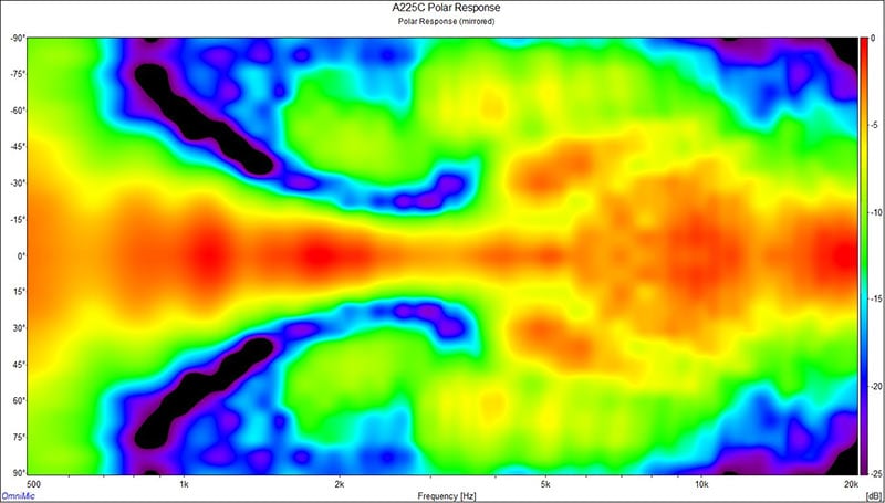

A225C Polar Response
The polar response graph shows how a loudspeaker performs at various angles.  The polar response graph above is generated by measuring a loudspeaker at 7.5 degree intervals around a circle on the tweeter axis from 1 meter.  This polar response graph is indicative of a M-T-M configuration.  The majority of the energy is in the 0 to 15 degrees of axis listening angles.  If listening at extreme angles the response of the center channel will have significant notches.  This configuration may be advantageous because the room interactions and interference pattern with left and right channels are reduced due to the reduced acoustic energy off-axis.

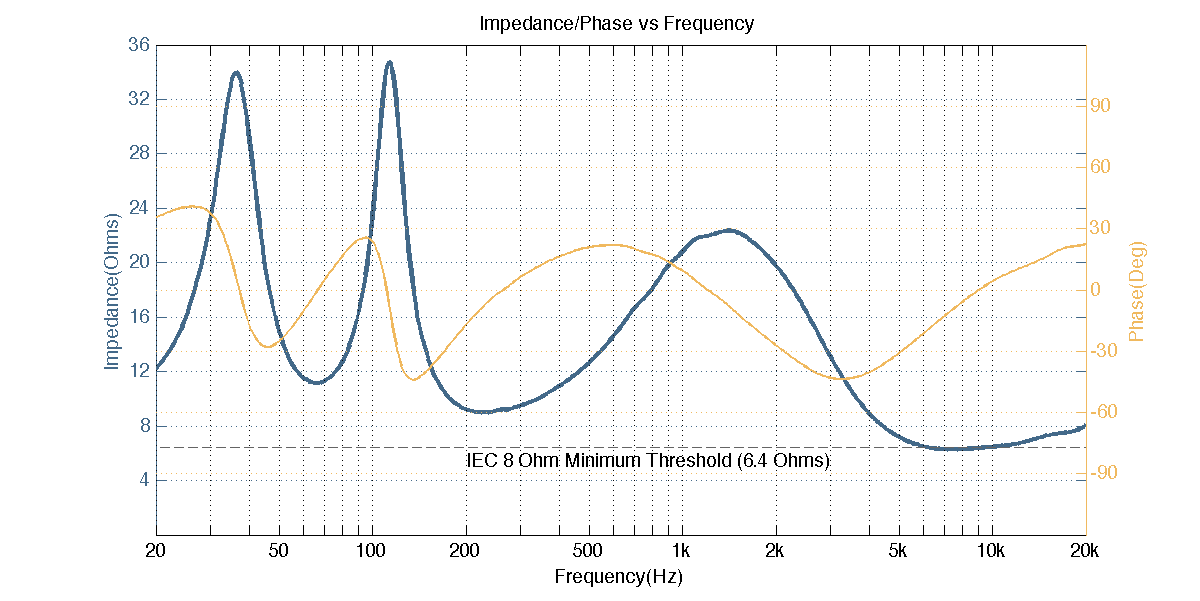

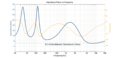

A225C impedance
A225C Impedance
The impedance of the A225C dips slightly below 6.4 Ohms IEC minimum rating for 8 ohm speakers between 6300Hz and 9200Hz.  This should not pose any problem for most amplifiers on the market.  The impedance graph above indicates the port tuning frequency is at approximately 65Hz.

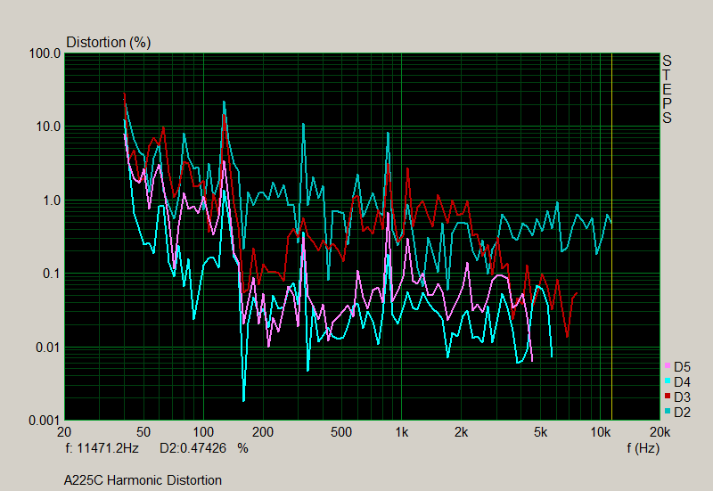

A225C Distortion
A225C Harmonic Distortion
The harmonic distortion graph is generated using a stepped sinusoidal sweep excitation signal calibrated to reach 90db at 2 meters.  This is a loud signal for a small center channel and the harmonic distortion graph shows that the A225C disagrees with playing much below 50Hz.  The sweep indicates distortion peaks at 800Hz and at approximately 300Hz.  These were not offensive or even detectable during listening tests.

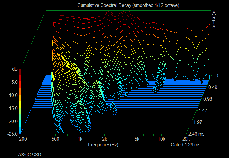

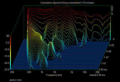

A225C Cumulative Spectral Decay
The cumulative spectral decay shows how sound at various frequencies dies out as a function of time.  It is important to note that the left most ridge is not valid and is a product of the measurement technique.

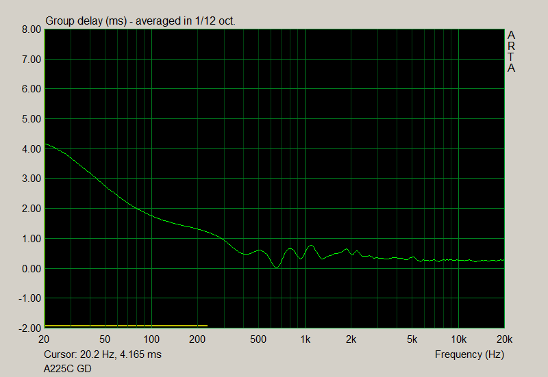

A225C Group Delay
A225C Group Delay
The group delay graph shows the rate of change of the slope of a loudspeaker’s phase.  As a rule of thumb, values below 1.6ms in the mid to high frequencies will likely not effect perception of sound quality.  Increasing group delay in the low frequencies is not as objectionable as it is in the mid to high frequency ranges.  The group delay of the A225C is perfectly acceptable.
