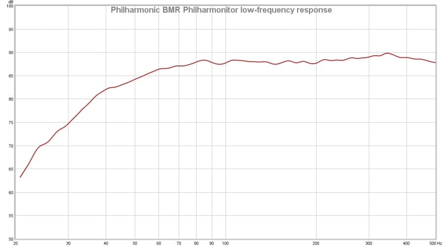

- Frequency Response: 34 Hz - 20kHz (+ / - 2db) Anechoic

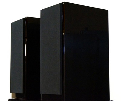

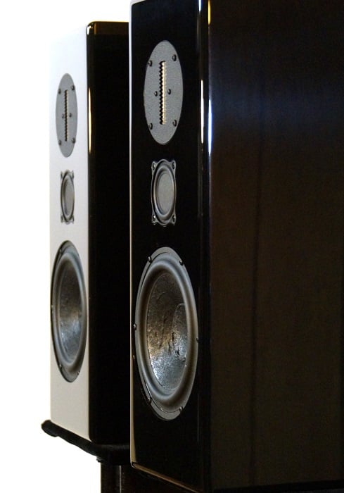

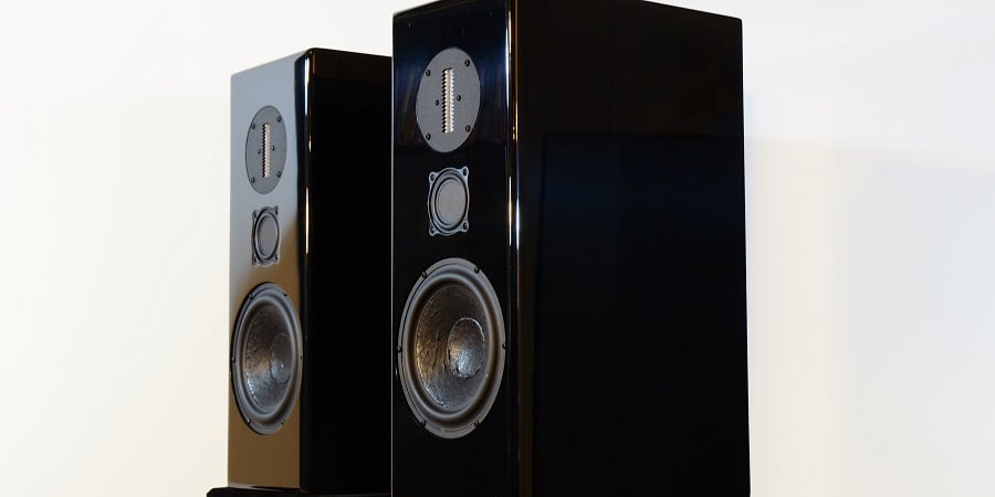

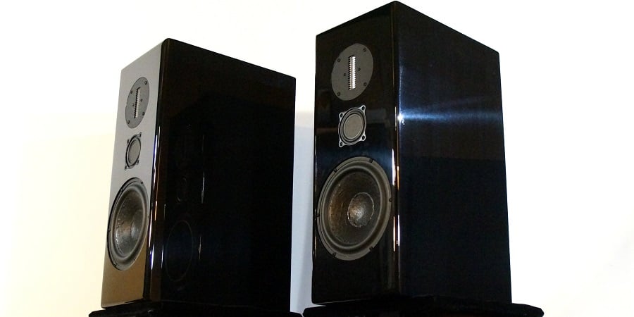

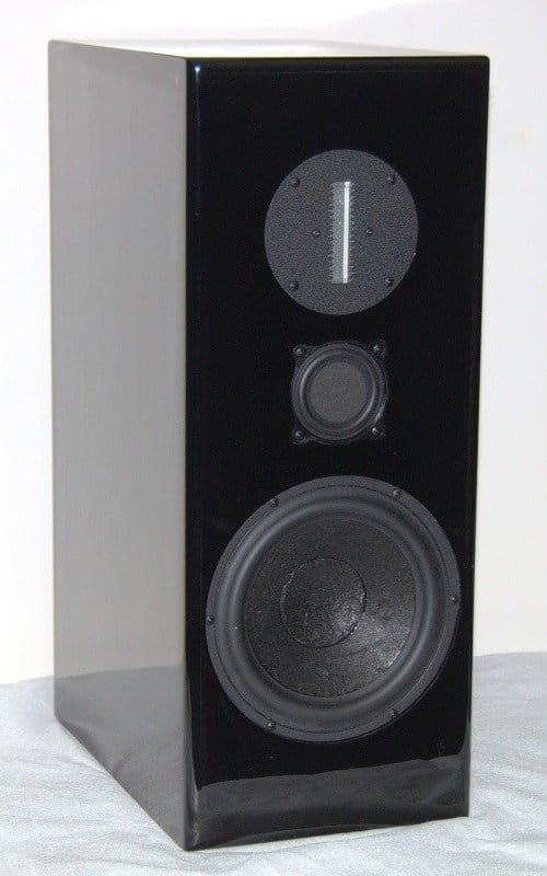

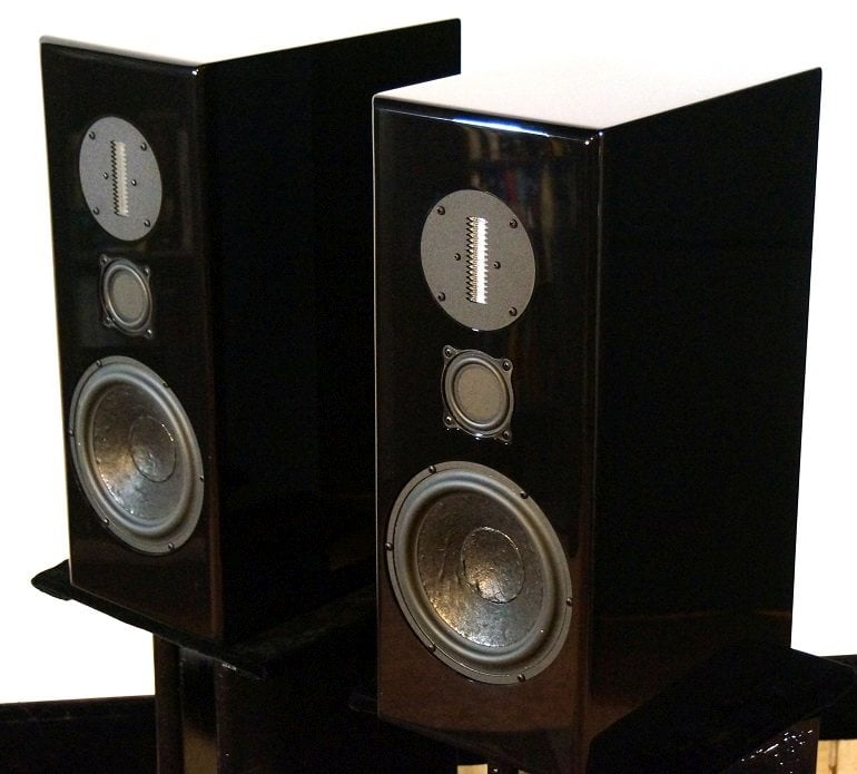

Unpacking and Appearance

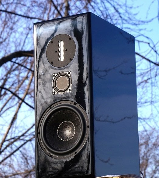

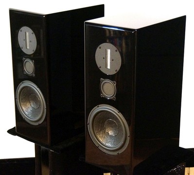

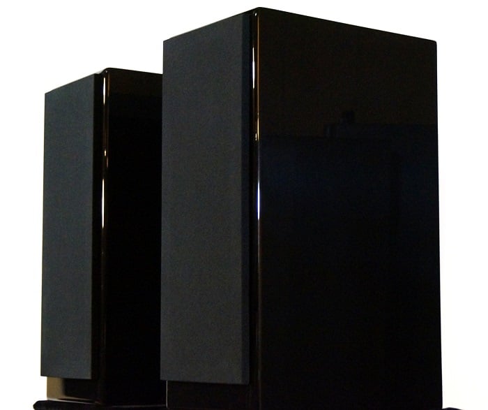

The BMP Philharmonitors arrived in two jumbo boxes that were unusually big for bookshelf speakers. This isn’t all that surprising, since I knew these speakers were on the larger side for bookshelf speakers, but they were still unexpectedly large. Each speaker was packed using double boxing and also two large stiff foam blocks that completely surrounded it. The speakers were covered in a soft foam bag to protect them from scuffing and moisture. It is apparent that Mr. Murphy did not want to waste his time with damage claims because these are some of the best-packed bookshelf speakers I have ever seen. Most speaker packing uses top and bottom foam blocks to fit the speaker in the box, but this set uses a very thick piece that guards against anything that could pierce the boxing anywhere around the speaker. It would take particularly abusive transit to cause any damage to these speakers.
Once unpacked, the BMR
Philharmonitors are revealed to be attractive and handsome speakers. ‘Handsome’
is a more operative word here than
‘pretty,’ since the BMR Philharmonitors are
a bit too serious to be called pretty in the conventional sense. I received the
standard version of the BMR Philharmonitors, which have a tall, oblong
enclosure in a gloss black finish and rounded edges. As bookshelf speakers go,
these were almost stately-looking; they were simultaneously elegant yet
business-like in their demeanor. The differently-sized circular frames of each
of the drivers against the black backdrop of the finish give the BMR
Philharmonitors a slightly cosmic aesthetic, as though the drivers were an
alignment of planets against the monolithic cabinet (cue ‘Thus Spoke
Zarathustra’). With the grille on, the speakers turn much more stylistically
minimal, of course, as gloss black boxes with a muted black fabric front. They
are shipped with some small ‘Philharmonic’ stickers that the user can choose to
apply to the front grille. I like a cleaner appearance so I declined to do
that. As usual, I prefer the appearance of the speakers with the grille off.
Due to their simple, clean appearance, the BMR Philharmonitors could fit in
almost any style of interior decoration, from modern to traditional.

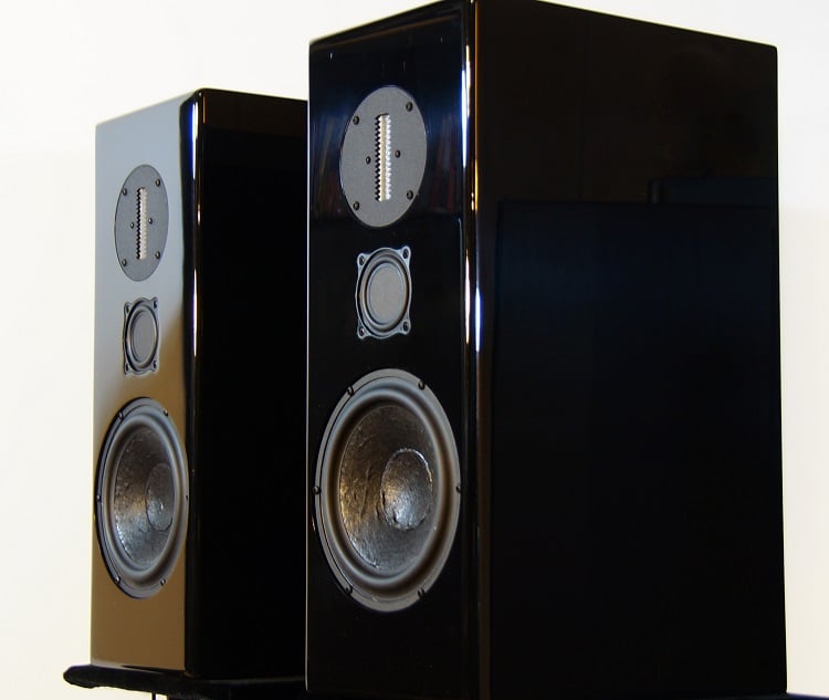

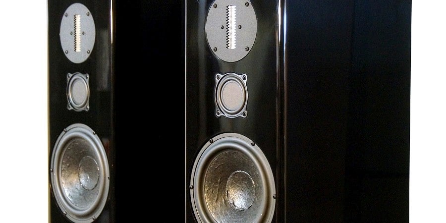

To sum them up very simply, the BMR Philharmonitor is a three-way, ported bookshelf speaker, but these are not simple speakers. Bookshelf speakers do not normally come in three-way designs, although that kind of design isn’t all that rare. However, the three-way design chosen for the BMR Philharmonitor is quite unique. One of its unique traits is the driver selection, so let’s begin our discussion of the BMR Philharmonitor by talking about the drivers used in its design, and we will start at the top: the tweeter.

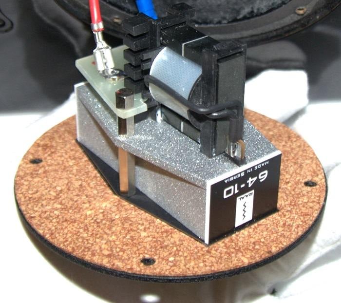

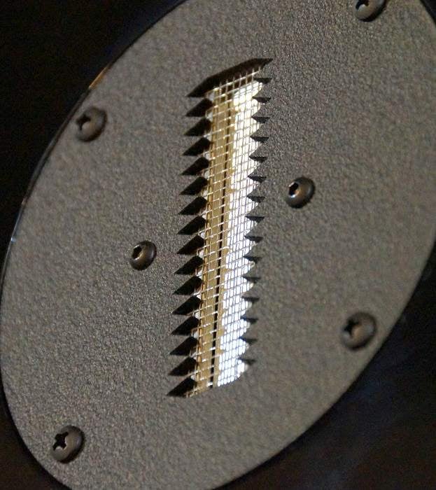

The BMR Philharmonitor uses a ribbon tweeter by the highly-regarded Serbian manufacturer RAAL. Ribbon tweeters are normally found on expensive speakers and are highly sought-after for their linearity, detail, and high-frequency extension. What makes a ribbon tweeter so special? The answer is the low mass of the diaphragm. Ribbon tweeters work by placing very thin, conductive ribbon that is usually either conductive tracings on a material like Kapton or simply a very thin aluminum strip in a tightly-controlled magnetic field between two permanent magnets. When alternating current is run through the ribbon, it vibrates as its magnetic charge rapidly oscillates between positive and negative. Proponents of ribbons claim they are better as high-frequency reproducers than domes because their moving mass is much lower than domes and therefore can accelerate and decelerate much more quickly, and this quicker movement makes for a more realistic sound. However, ribbons have historically had a few disadvantages. Among those disadvantages is they are more expensive to manufacture, and they were fragile, so they were not as capable in midrange frequencies as in treble. They also need a transformer to raise their electrical impedance to a usable level, which naturally raises their manufacturing cost and makes them a larger component. The BMR Philharmonitor addresses the low-frequency fragility by just using the ribbon where it is strongest, at mid-treble frequencies and above and not tasking it to play outside of its comfort region.

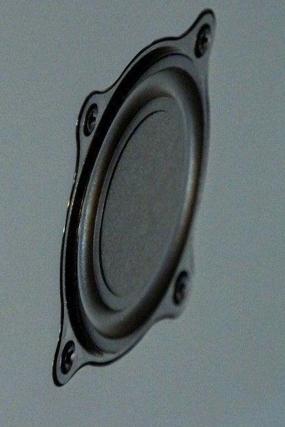

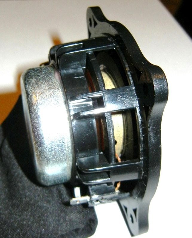

It is said that music lives in the mids, so the midrange driver in a three-way speaker is crucial in getting a good sound. Philharmonic has chosen a peculiar and perhaps revolutionary midrange driver to serve this range. It is the Tectonic BMR (more specifically the TEBM46C20N-4B) which, of course, is referred to in the name of the speaker. The ‘BMR’ stands for ‘Balanced Mode Radiator.’ It’s not an expensive component but it is a sophisticated piece of engineering nonetheless. It is an extremely wide-band, flat-diaphragm, 3” driver that uses weighted rings on the diaphragm to dramatically reduce cone break-up. Cone break-up occurs when the excursion of the driver happens so quickly that the cone can’t keep a uniform shape and begins to bend in various ways. This happens to all drivers at high enough frequencies, and the results are that the response starts to get heavily distorted past a certain frequency. The larger the cone, the lower in frequency that break-up will start to affect the response, and this is one of the reasons why midrange drivers are smaller than bass drivers, and dome tweeters are smaller than midrange drivers. Filtering out break-up artifacts has always been a challenge for loudspeaker designers, so any driver that doesn’t have as much of a problem in this respect makes designing a good speaker much easier. The exact method that Tectonic uses to reduce break-up with their weighted rings is rather complex but is explained in this white paper.

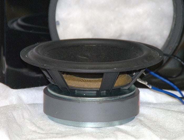

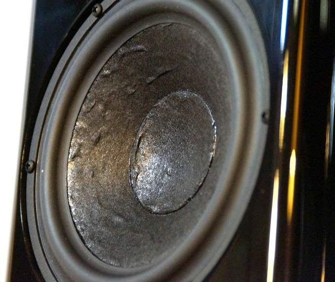

The woofer used in the BMR Philharmonitor is the 18W/8545-01 which is the latest iteration of the acclaimed 8545 series from the highly-regarded Danish manufacturer Scan-Speak. This 7” diameter woofer uses a paper/carbon fiber cone in a cast aluminum frame with a beefy 4 ¾” diameter magnet and 1.5” voice coil. It uses Scan-speak’s ‘Symmetric Drive’ motor design which is a patented way to arrange shorting rings and a copper cap in order to reduce the deleterious effects of induction by providing a symmetric induction around the gap center point.

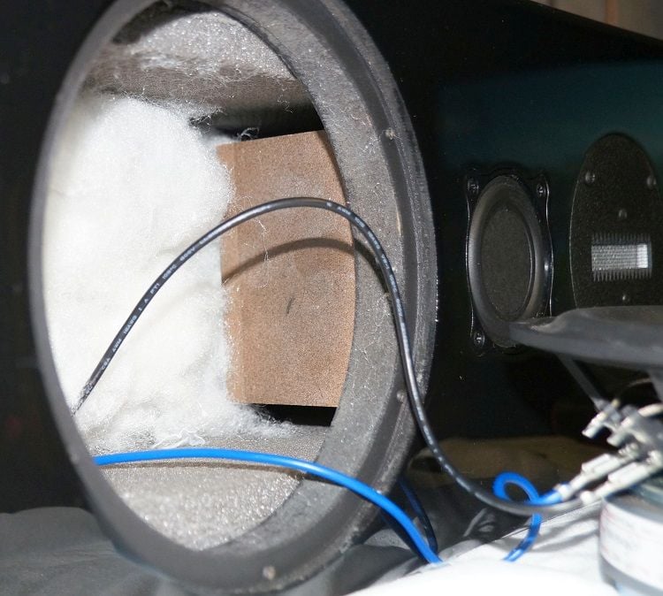

The BMR Philharmonitor is a
hefty bookshelf speaker, at 34 lbs., and most of that weight is composed of the
cabinet. The cabinet uses MDF construction and has a 1” thick front baffle with
¾” thick side panels and bracing. The midrange driver is housed in its own
isolated compartment so that backwave radiation from the woofer won’t affect
its operation and also to give it a better enclosure space with more optimal
backwave pressure for its own operation. There are two pieces of bracing that
jut out from the top of the
midrange compartment to strengthen the side panels.
The BMR Philharmonitor uses three types of acoustic treatment on the inside of
the cabinet: polyfill filling the inside of the cabinet, Sonic Barrier acoustic
damping lining the walls, and Acoustimac’s Ecocore acoustic insulation lining
the top of the cabinet and inside of the midrange compartment. I am told by the
BMR Philharmonitor designer Dennis Murphy that Ecocore is essential as stuffing
for the midrange chamber since nothing else will load the BMR driver properly.

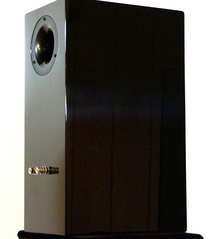

The BMR Philharmonitor is rear-ported with a 7” long, 2” diameter port that is heavily flared on both ends. That is a very long port for a bookshelf speaker that ought to make for a very low port resonant frequency. Port tuning was done by award-winning speaker designer Paul Kittinger who is known for his work on more complex transmission line cabinets. One aspect to note here is that these speakers dig ambitiously low in bass for bookshelf speakers- even large bookshelf speakers- with a listed spec of 34 Hz to 20 kHz in a +/- 2 dB window. That will inevitably have a cost in sensitivity, so while these speakers may be able to hit those very low notes, it will not do so as efficiently as a larger tower speaker could for the same wattage. Indeed, its sensitivity is listed as 85 dB for 2.83v at 1 meter, which would be below what one might expect for a bookshelf speaker of this size, although not so much when its low-frequency extension is factored.
The BMR Philharmonitors do
not come with feet installed. For those who want to use feet, Dennis Murphy
recommends Sorbothane isolation feet. There is no terminal cup in the back but
simply some five-way binding posts that stick out of the back of the speaker.
The advantage of the omission of a terminal cup is that the ¾” MDF is a lot
more rigid and will better contain the acoustic
energy inside the enclosure.
The disadvantage is that the binding posts just kind of stick out there and are
more vulnerable to catching something or hitting something, thereby incurring
damage. The grille uses magnetic attachment so the front baffle keeps a clean
look. The grille uses an acoustic fabric stretched over a thick MDF frame. That
frame is bound to increase diffraction, so for the best sound, use the speakers

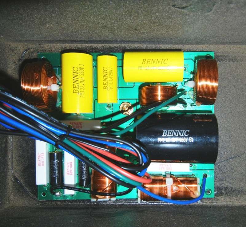

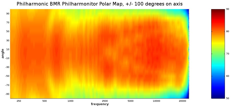

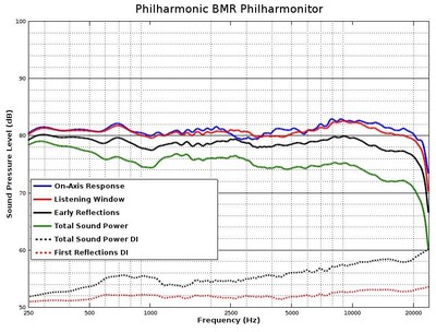

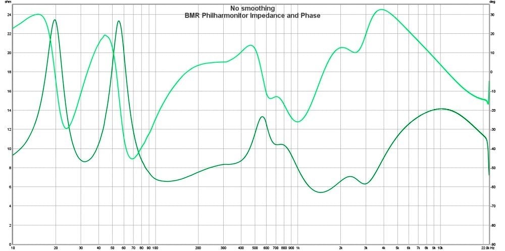

The crossover circuit looks like a very substantial design, with a handful of beefy polypropylene capacitors, air core inductors, two steel laminate inductors, and four resistors, all neatly organized to fit in a small space. The woofer crossover to the midrange driver is at 600 Hz, and the midrange driver crosses over to the tweeter at 3.5 kHz, using 4rth order Linkwitz-Riley filters in both sections. That explains why the crossover circuit is so heavy-duty; it must be to handle that degree of complexity.

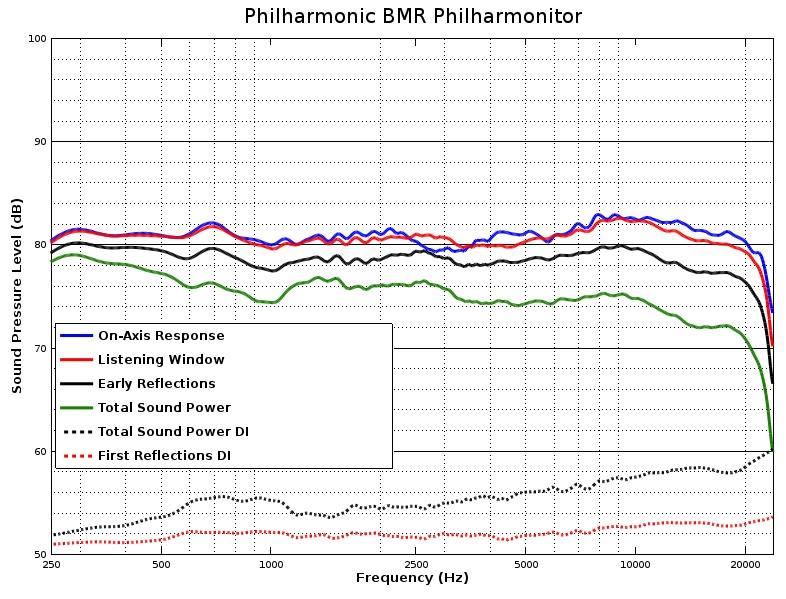

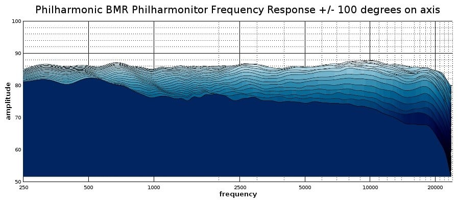

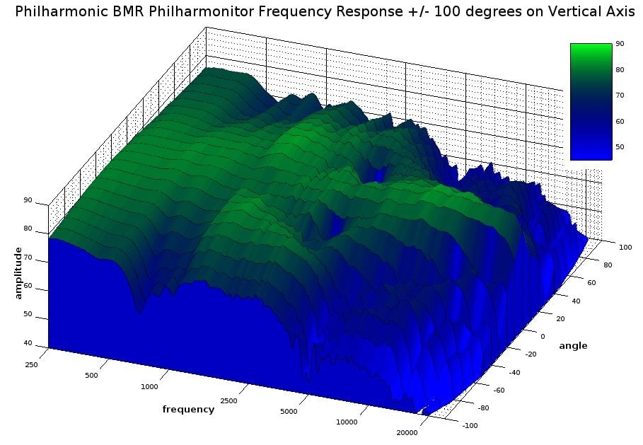

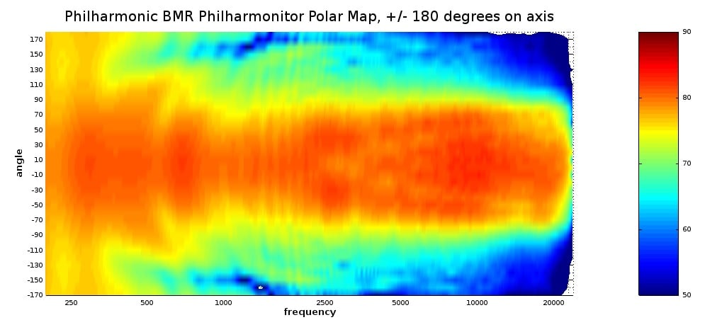

The overall design of the BMR Philharmonitors suggests a speaker that will have very wide dispersion, relatively deep bass, and somewhat lower sensitivity. Narrow tweeters such as the ribbon tweeter used on the BMR Philharmonitor tend to emit sound at a wide horizontal angle but a narrow vertical angle. The small size of the midrange driver would be expected to have a wide dispersion out to treble frequencies in all directions, since sound of frequency wavelengths larger than the diameter of the driver cone normally project out at a wide angle. With a 3” diameter, the BMR midrange drivers should be capable of wide dispersion out to well past its 3.5 kHz low-pass frequency, and the 7” woofer of the Scan-speak bass driver will certainly have a very wide dispersion out to its 600 Hz low-pass frequency. The long length of the port indicates that the BMR Philharmonitor will have a fairly low tuning frequency, so the low-frequency spec of 34 Hz is plausible. And, as was discussed before, that will inevitably have an impact on efficiency. We will see how these design decisions play out in the “Measurements and Analysis” section, but for now, let’s do some listening!

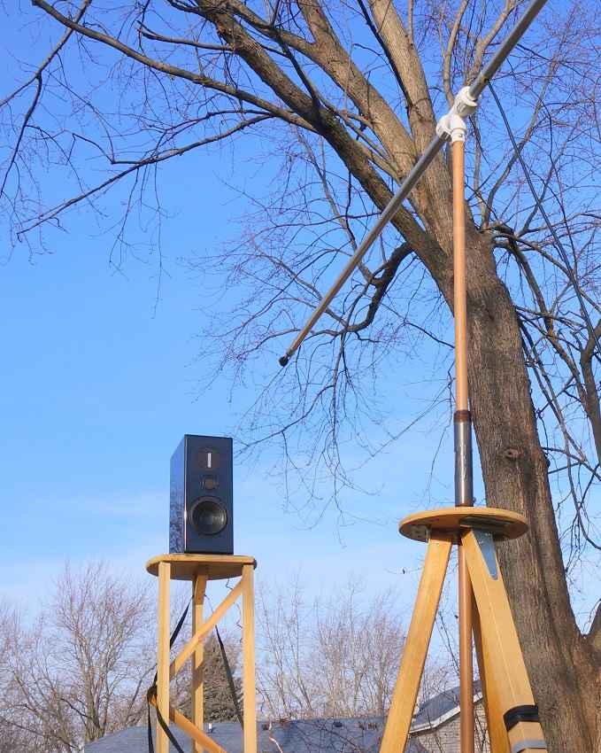

The Philharmonic BMR Philharmonitors were measured in free-air at a height of 7.5 feet at a 2-meter distance from the microphone, and the measurements were gated at a 8.5-millisecond delay. In this time window, some resolution is lost below 250 Hz and accuracy is completely lost below 110 Hz. Measurements have been smoothed at a 1/12 octave resolution.

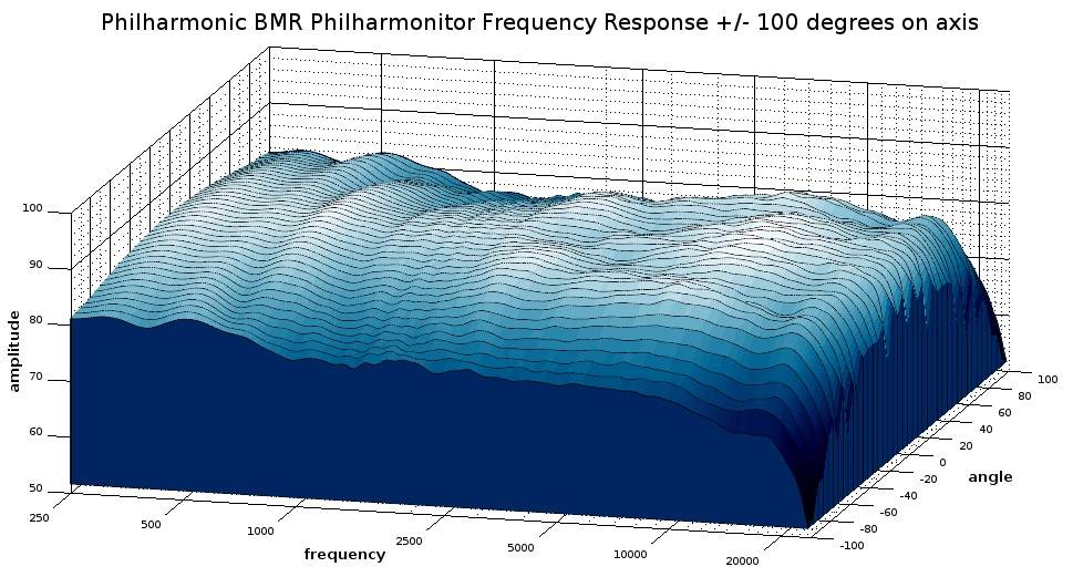

The above graph shows the direct-axis frequency response and other curves that describe the speaker’s amplitude response in a number of ways. For more information about the meaning of these curves, please refer to our article Objective Loudspeaker Measurements to Predict Subjective Preferences.
This is a number of notable attributes within these curves, and they are all good. The direct axis, listening window, and early reflection curves exhibit a superbly neutral response. That means that this is a very accurate loudspeaker both on and off axis. The uniformity that the sound power and early reflections curves show that this is a very wide dispersion speaker, as its design would indeed suggest. Both directivity indexes are very flat and show no sudden changes or irregularities. That means the BMR Philharmonitors should have a very consistent beamwidth over frequency, where the off-axis response holds a tight correlation to the direct axis response. This all adds up to a wide dispersion and flat response over off-axis angles as we shall see below.
The above graphs depict the BMR Philharmonitor’s lateral responses out to 100 degrees in five-degree increments. As was suggested by the above directivity index curves and ‘First Reflections’ curves, we can more explicitly see how the wide the dispersion is and how well it correlates to the direct axis response. These are outstanding measurements that show an extraordinarily neutral response. These speakers are more than sufficient in accuracy to be used as mid-field studio monitors for recording engineers. They tell the truth about whatever signal is sent to them without adding or subtracting much of anything. There is an ever-so-slight rise above 9 kHz, but this is going to do very little to color the sound reproduction. This is the most neutral loudspeaker I have yet measured. Normally I comment on how a speaker might do a particular frequency band well such as the midrange or the high frequencies, but this does everything well. Nothing stands out; it is all superb. The integration between the drivers from the crossover is very well done, especially since the drivers used are all dramatically different in design.

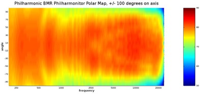

Philharmonic BMR Philharmonitor Horizontal Response +/- 100 degrees: Polar Map
The above graph shows the same information that the preceding graphs do but depict it in a way that can offer new insight regarding these speakers’ behavior. Instead of using individual raised lines to illustrate amplitude, these polar maps use color to portray amplitude and this allows the use of a purely angle/frequency axis perspective. The advantage of these graphs is they can let us see broader trends of the speaker’s behavior more easily. The first thing to note about this measurement is the extraordinarily even dispersion out to an astounding 80 degrees. There is some mild waist-banding a bit above 1 kHz, but that only squeezes the response down to 60 degrees or so. That isn’t likely to be deleterious on the sound at all. The dispersion in the tweeter’s frequency band is a sight to behold: very smooth, very linear, very even within its entire range. This RAAL tweeter lives up to its reputation here as a first-rate tweeter. The dispersion is so wide here that a polar map showing 100 degrees off axis doesn’t quite give enough context for how extraordinary this dispersion pattern is, so let’s expand this angle to a full 180 degrees:

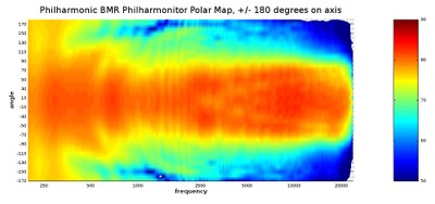

Philharmonic BMR Philharmonitor Horizontal Response +/- 180 degrees: Polar Map
Keep in mind that the above graph is showing the complete horizontal dispersion of the BMR Philharmonitor, so the very top and very bottom of the graph is showing the response directly behind the speaker. The reason why I am posting this graph is to more clearly show how well-controlled the dispersion is here. What this graph is telling us that that the sound is being projected in a wide but controlled angle, so almost anywhere in front of this speaker will provide a well-balanced tonality. The sound of this speaker does not change its character over a very broad angle in front of it. The reason why this is important is that much of what we hear from a speaker in room is due to the acoustic reflections from room surfaces and large objects rather than direct sound from the speaker itself, and these reflections come from off-axis angles from the speaker. If the off-axis response of the speaker is erratic, that will be heard, so even if a speaker has a nearly perfect direct axis response, it can have a poor tonality if the off-axis response is markedly irregular. That is especially true for a speaker with dispersion as wide as we see with the BMR Philharmonitor. The wider a speaker’s dispersion is, the greater the ratio of reflected sound to direct sound, so it is critical that a speaker of this design type holds an even, uniform dispersion, and the BMR Philharmonitor does this magnificently well. Their tonal character does not change much with respect to angle.

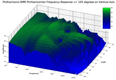

Philharmonic BMR Philharmonitor Vertical Response +/- 100 degrees
The above graph shows the BMR Philharmonitor’s response behavior along its vertical axis where zero degrees is directly in front of the tweeter, negative degree values are below the tweeter, and positive degree values are above the tweeter. It should be said here that the vertical response isn’t nearly as critical as the horizontal response, so an imperfect vertical dispersion is much less of a problem. There are a few interesting features in the graph of the BMR Philharmonitor’s vertical response. One thing we can see is that while the BMR midrange driver has a wide vertical response, the RAAL tweeter has a narrow vertical response. This is no surprise, given their designs, but it is interesting to see their behavior on this axis. We can see two notches that occur around 30 degrees above and below the tweeter; these are cancellation nulls from the midrange driver and tweeter at a distance difference that puts their overlapping output out of phase around their crossover frequency. We also see some waist-banding at far off angles from cancellation between the woofer and midrange driver. Again, nothing here should alarm readers, since performance on this axis isn’t nearly as important as the horizontal axis. The lesson here is that these speakers are best heard within a 20-degree vertical angle of their tweeter; that will very likely be the case in any normal speaker system.

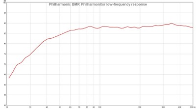

Philharmonic BMR Philharmonitor groundplane bass response
The above graphs show the BMR Philharmonitor’s low-frequency responses that I captured using groundplane measurements (where the speaker and microphone are on the ground in a wide open area). We can see a nicely flat response with a shallow rolloff starting at around 70 Hz. At a bit under 40 Hz, the rolloff becomes considerably steeper since it is below port tuning. This shallow rolloff is normally a good idea in order to take advantage of low-frequency room gain. Tuning the speaker flat down to the port tuning frequency would likely result in a boosted bass response in typical room use. In my own room, the bass sounded very natural, so a dead flat response down to the port tuning of 34 Hz would likely have sounded like somewhat exaggerated bass.

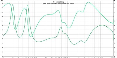

Philharmonic BMR Philharmonitor Impedance and Phase
The above graphs show the electrical behavior of the BMR Philharmonitors. The impedance and phase stay within safe limits of almost any amplifier. The most taxing region here would be at about 1.5 kHz where the minima occurs at 5.4 ohms with a -5.3-degree phase angle. That would only be a hard load for the cheapest of amplifiers if the speaker was played loud with content in that range. Overall, this speaker should be an easy load with the vast majority of amps. Philharmonic’s spec of this speaker being a 6-ohm load is conservative. We can see from the saddle dip in the low-frequency region that the port tuning point is just above 30 Hz which makes this a very deeply-tuned bookshelf speaker. The equal heights of the impedance peaks in the low frequencies indicate that, despite this speaker’s unusually low port tuning frequency, its port length looks correct for the enclosure size. There are no wrinkles or ripples so the enclosure seems to be well damped and braced with no evidence of worrisome cabinet resonances.

Now let’s go over the advantages of the BMR Philharmonitors, many of which were already mentioned as counters to any serious criticism that one could have against them. As was said before, their sound quality is outstanding. There are many speakers that cost many times the price of these without equaling their sonic accuracy. Their dispersion is wide yet very well controlled. Their bass extension is the best I have seen from a bookshelf speaker, and the bass quality itself is superb much like the rest of the frequency range. As I said before, I can’t really pick out a standout aspect of its sound quality because it does everything so well. They are one of, if not the most linear speakers I have yet measured. In fact, they have such a linear response both on and off axis that they nearly attain a certain ideal for those who are interested in wide-dispersion loudspeakers. Wide dispersion loudspeakers have the advantages of broad coverage of an area with a consistent tonality so listeners could be seated anywhere in front of them and hear a similar response. They also have a greater ratio of reflected sound to direct sound, and this can give them a more open and spacious character.
Also, as was mentioned, they look pretty sharp. Gloss black in a cabinet with rounded corners is a fairly standard approach to get a nice-looking loudspeaker, but hey, what can I say, it works. Of course, finer finishes are available at higher prices, but the standard gloss black looks pretty swank to me. One detail that I can appreciate is the grille uses magnetic fasteners, so the front baffle has that much of a cleaner appearance without the grille since there are no grille guides. The overall build quality of the BMR Philharmonitors is very good and easily meets, if not surpasses, what one would expect at this price point. Another point in their favor is that their electrical behavior makes them an easy load to run on most amplifiers.
As a loudspeaker reviewer, I receive a lot of loudspeakers, and sometimes I run across a product so delightful that I am tempted to purchase it for myself. The BMR Philharmonitors is one such product. The only problem is that I have to spend so much time using other speakers under review that I seldom get a chance to use my own equipment anymore, and speakers as good as the BMR Philharmonitors ought to be used frequently instead of put away in a box somewhere for use only during certain occasions. So, it is with a heavy heart that I am returning these. However, those looking for a high-quality and very high-fidelity loudspeaker that they will end up listening to often should give the BMR Philharmonitors a very close look because for most people I am sure they will absolutely be keepers. Philharmonic Audio offers a two week trial with any of their speakers where the buyer only has to pay shipping costs, so potential owners can demo these without much risk or expense. To bring this review to a close, I can only say that I am hoping that I get another opportunity to spend someday with the BMR Philharmonitors; to paraphrase Vera Lynn, don’t know where, don’t know when, but I am hoping we will meet again!
