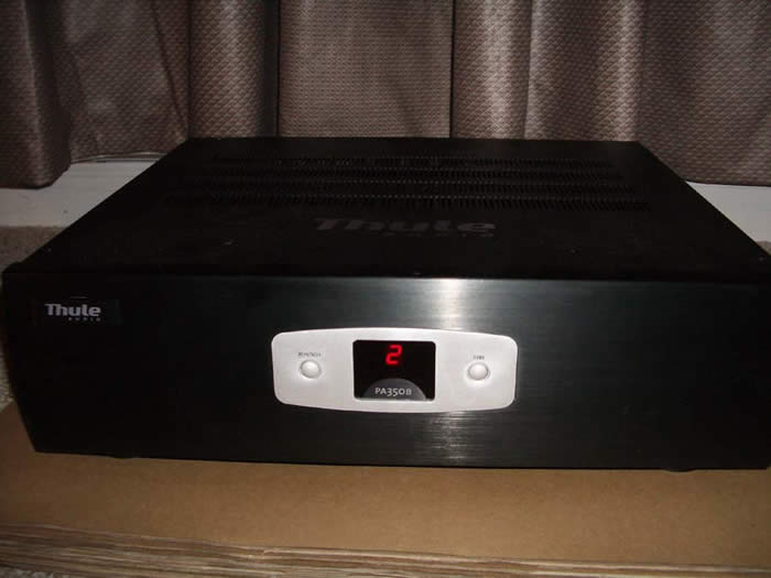

The Thule PA350B is a rather unique amplifier in the sense that it is the first I've run across with 3 power switches! That's no typo, there is a Mains power switch located on the back of the chassis, a Fault switch located below the unit, and a Stand By front panel power switch. I can appreciate the manufacturer's passion for safety, but I found the bottom chassis fault switch to be more of a nuisance than a benefit, especially after I loaded the unit in my Middle Atlantic Rack and found out the hard way it wouldn't power up because I accidentally disengaged power to the fault switch when installing the 48lb amp at the top of my rack.
According to the manual, the PA350B requires an unusually long 2-4 hours to warm up and reach peek performance if cold started from the mains power switch, but only requires 10-15 minutes of warm up time if the unit is left in standby mode and then becomes active. While I can understand the benefits of allowing an amplifier to reach thermal equilibrium, I am uncertain as to why it would take as many hours as the manufacturer claims from a cold start. Nonetheless, I left the amp on for several hours before engaging in any critical listening tests or undergoing my power measurements.
The PA350B can be triggered to toggle between 2CH and 5CH mode in three ways:
  • Auto sense mode - if it detects signal on center channel it automatically switches to 5/7 CH mode
  • Manually on front knob by pressing the 2CH/5CH button
  • Their proprietary data port which interfaces with their matching preamplifier
One operational quark that irked me regarding the bridged 2CH mode is that the unit automatically reverted back to balanced inputs each time it was power cycled. Since I wasn't using their matching preamp to provide it data logic, I had to use some nifty Impact Acoustics unbalanced to balanced cables between the preamp of my Denon AVR-5805 receiver to this unit to always ensure I had audio signal present.
The PA350B sports all high quality WBT style banana speaker terminals and gold plated RCA jacks with two balanced inputs for the high power 2CH bridged mode. It has no 12V trigger options (a disappointment to me) though the unit can be trigged via the proprietary data port connection if you are using their matching preamp. The S1 & S2 connections are intended for upgrading this unit to 7 channels of amplification.

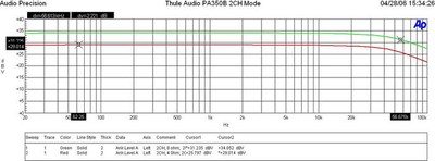

In 2CH bridged mode, the PA350B was able to achieve a whopping 317wpc with two channels driven continuously above 50Hz (-3dB point around 53kHz) with less than 0.1% THD + N into 8 ohms. However, when driving 2 channels simultaneously, I was unable to exceed 265wpc x 2 without having the amp shut off if driving any greater power levels at low frequencies (below 50Hz) for sustained continuous conditions. This isn't surprising since in order to deliver 317wpc x 2 continuously, the power supply would have to be capable of delivering (317 x 2 / .5) = 1268 watts which the two 500VA transformers in this amplifier aren't capable of delivering. The amp would require at least 750VA dual transformers to accomplish such a feat. This would likely never be an issue in real world since we don't listen to continuous correlated test tones.
I was able to achieve unclipped 500wpc continuously at (0.1% THD + N) into 1 channel driven at 4 ohms. Unfortunately, the amplifier didn't have a large enough power supply to deliver its full power rating continuously into 2 channels. If I drove it any higher than 200wpc x 2 continuously at full bandwidth into 4 ohms, the amplifier would shut off. This is an unlikely real world scenario but something to be mindful of if you have an appetite for achieving LOUD SPL levels from 4 ohm, moderately sensitive ( < 89dB @ 1 watt/meter) into a large theater room (3000 ft^3 or more). Also keep in mind most review publications don't do continuous power measurements and this observation would have went unnoticed in their test procedures.
The PA350B is rated to deliver 350wpc x 2 into 8 ohms or 500wpc x 2 into 4 ohms but the manufacturer doesn't specify if this is a continuous rating with both channels driven, though its kinda obvious it isn't given the size of the power supply, and the rated max power consumption of 1000 watts, thus one cannot call the ACD power police on them for not meeting their power specification since I was able to validate it for at least 1 channel driven into 8 and 4 ohm loads on a continuous full bandwidth basis at 0.1% THD + N despite the manufacturer didn't even specify distortion limits of their ratings.

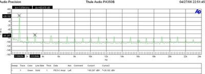

FFT Distortion Analysis
5CH Mode FFT Analysis
At 1 watt into 8 ohms, the PA350B exhibited impressively low distortion (8.879+104.055)dBv = 112.9dBv or 100*alog^-1(-112.9/20) = .00026% This is one of the lowest distortion measurements we've seen and a tribute to the fully balanced output design topology of this amplifier.
2CH Bridged Mode FFT Analysis
At 550wpc into 4 ohms, the PA350B didn't falter at providing excellently low distortion, unadulterated power. (33.492+47.677)dBv = 81.169dBv or 100*alog^-1(-81.169/20) = .0087% A rare achievement for amplifiers running at full rated power and again attributed to its fully complementary output topology.

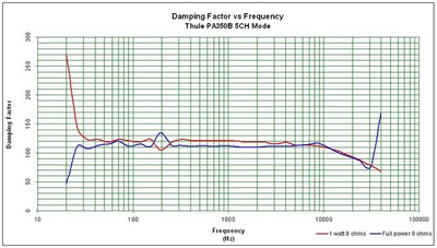

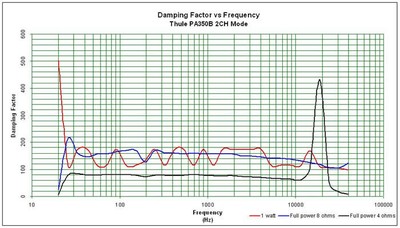

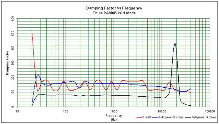

The amplifier output impedance was superb in both 5CH Mode and 2CH Bridged Mode. It maintained well under 100 mohms (our benchmark #) for the entire audio frequency range. This amplifier should sound very consistent between different speaker types assuming it isn't driven beyond its power limits.
The amplifier output impedance was again under 100mohns in 5CH mode and about half that in bridged mode. The increased output impedance below 20Hz indicated perhaps where they chose the pole for high pass filtering the low end response to block DC. Incidentally this is the frequency area that caused the amp to shut off if swept at full power - again a non likely real world scenario. The accentuated output impedance at 40kHz into a 4 ohm load in Bridged mode was a bit peculiar but since it was well out of the audio range, I didn't give it much thought for further investigation.
The damping factor of the Thule amp in 2CH bridged mode was uniformly excellent at all power levels and load impedances as was expected based on the measured output impedance. I was a bit puzzled as to why the amps output impedance had such a sharp rise at 20Hz, causing poor damping, when driven to full power. I could only assume it was some intentional protective measure to NOT overdrive the amplifier. This did not cause any audible hiccups in my listening tests however.
Even in 5CH mode, the Thule amp exhibited excellent damping characteristics, though the puzzling 20Hz loss of damping at high power was also prevalent.
