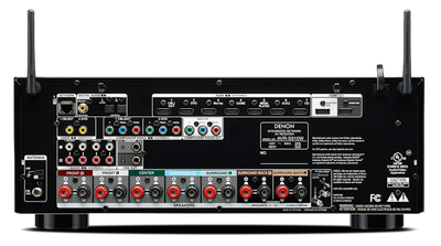

Denon AVR-S710W Back View

Denon AVR-S910W Back View
