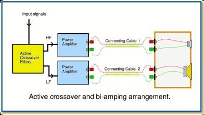

Active Bi-amping
Active bi-amping involves the use of an active crossover which splits the electrical signal into high and low frequencies before it reaches the amplifiers, consequently allowing each channel to only reproduce the range of frequencies required of it. In terms of audible differences, ditching the passive crossover boards in your speakers for an active bi-amping setup certainly has the potential to make a change, though whether this is positive or negative depends on the quality of implementation, as well as the quality of the passive crossover you’re replacing (generally speaking, we feel it’s difficult to meaningfully improve upon a very good passive crossover). Be warned: converting a passive loudspeaker to an active model is not an undertaking for the faint of heart due to the complexity involved as well as the costs (active crossovers as well as additional amplification and wiring).
From a technical standpoint, aside from possible improvements afforded by active crossovers, active bi-amping allows an amplifier to be directly coupled with a driver, having it to deal with a much more benign load than what a typical passive loudspeaker represents. This can also result in a more efficient system given that no energy is wasted as heat in passive crossover components. Intermodulation distortion in the amplifiers is reduced given that each amplifier channel is reproducing a smaller portion of the audio spectrum, and the split load also dramatically reduces the likelihood of tweeter destruction as a result of overdriving an amplifier. Last but not least, active bi-amping allows for a more efficient allocation of power, i.e. it’s possible to place a smaller amplifier on a relatively sensitive tweeter, and reserve the 1000W monster for the power hungry woofers.
Active Bi-amping Diagram

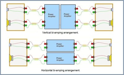

Horizontal vs Vertical Bi-amping
Horizontal and vertical bi-amping are further subsets which can be applied to both active and passive bi-amping, and imply the use of multichannel amplifiers. In a horizontal arrangement, one amplifier is used to drive the high frequency elements of multiple loudspeakers, while another amplifier is used to drive the low frequency elements. The benefit here is that you can pick amplifiers which you feel are best suited to their given task, i.e. you wanted to use a tube amplifier for the mids and highs, but a big solid state amp to drive the low end. A vertical arrangement switches things such that two channels from a single amplifier are used to drive both the high and low frequency elements of a single speaker. This can better balance resources, and keep one amplifier from getting overloaded with low frequency material while the other sails along reproducing the much less abundant high frequency content.
Note: It's important to utilize amplifiers with similar gain structures to ensure level matching between the low and high frequency sections of the speaker system for proper integration.
Horizontal vs Vertical Bi-amping Diagram
