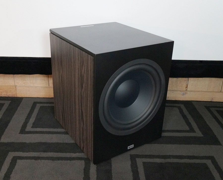

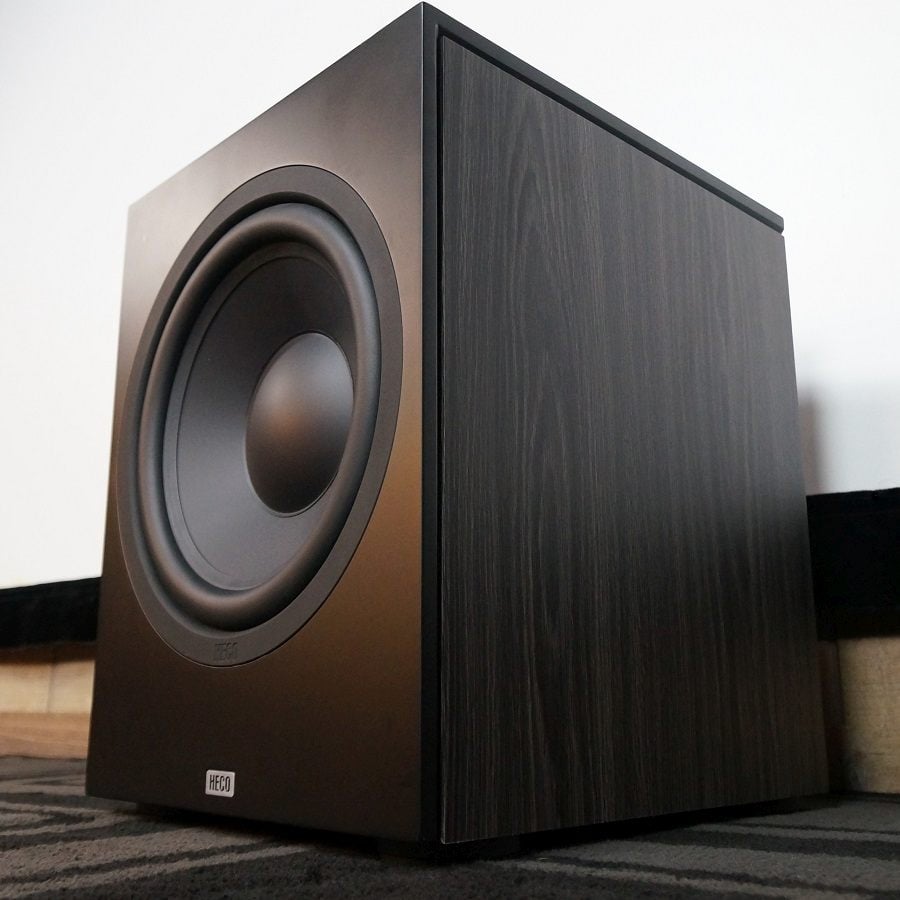

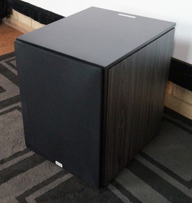

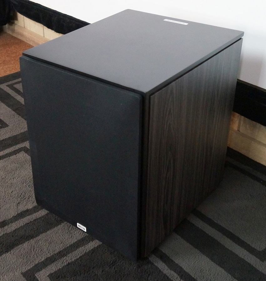

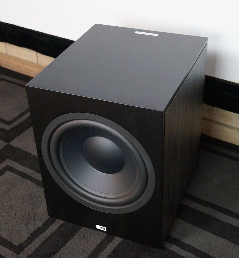

As affordable subs go, the Aurora 30A does look quite good. I received the “ebony black” finish, which has a satin black front baffle and top panel and an ebony wood veneer side paneling. The wood veneer is a vinyl imitation, of course, but not a bad one and not an obvious imitation unless examined very closely. The cone is a fairly normal-looking black unit with a convex dustcap. It’s the same kind of cone material used in HECO’s other speakers, so would make a good visual match for those who care. It can be hidden by a grille that covers much of the front baffle. The biggest aesthetic advantage of the 30A is its size. As ported 12-inchers go, it is certainly on the smaller side, and that makes it a lot more palatable for many situations, especially where spouse approval factor is a major concern. Its tastefully conservative styling should enable it to fit into a wide range of decors.

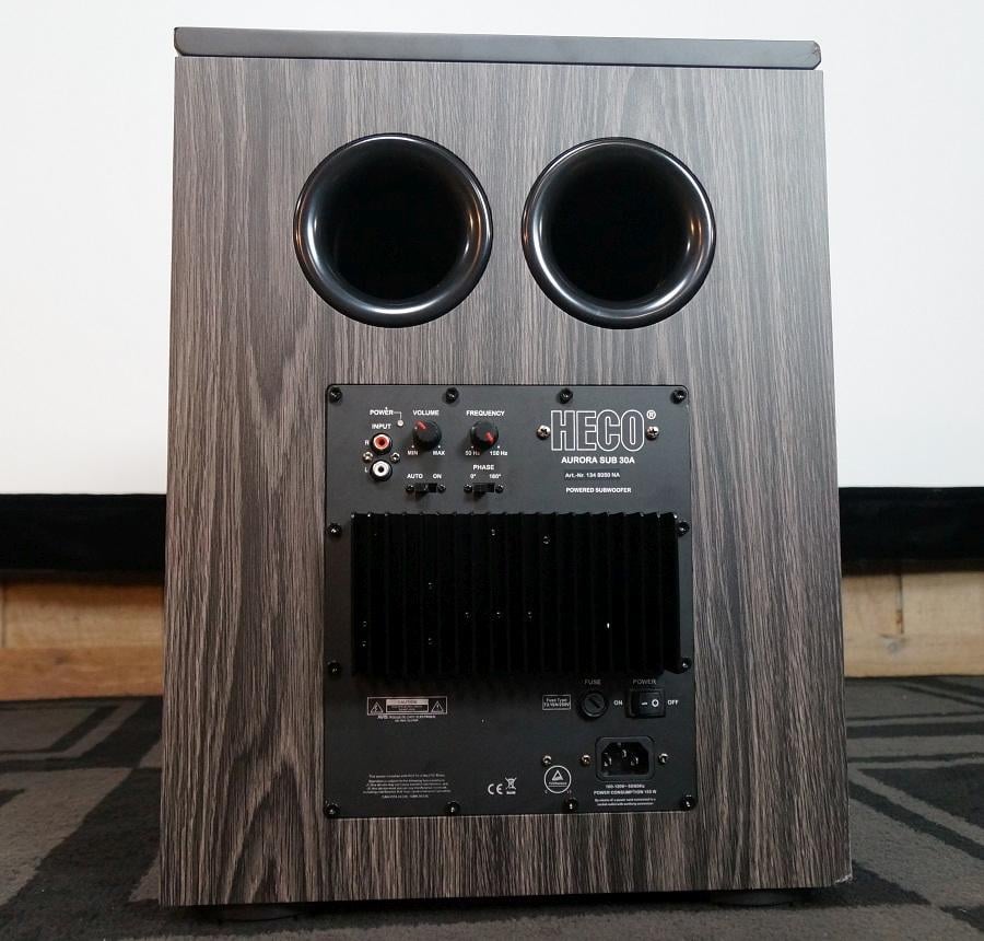

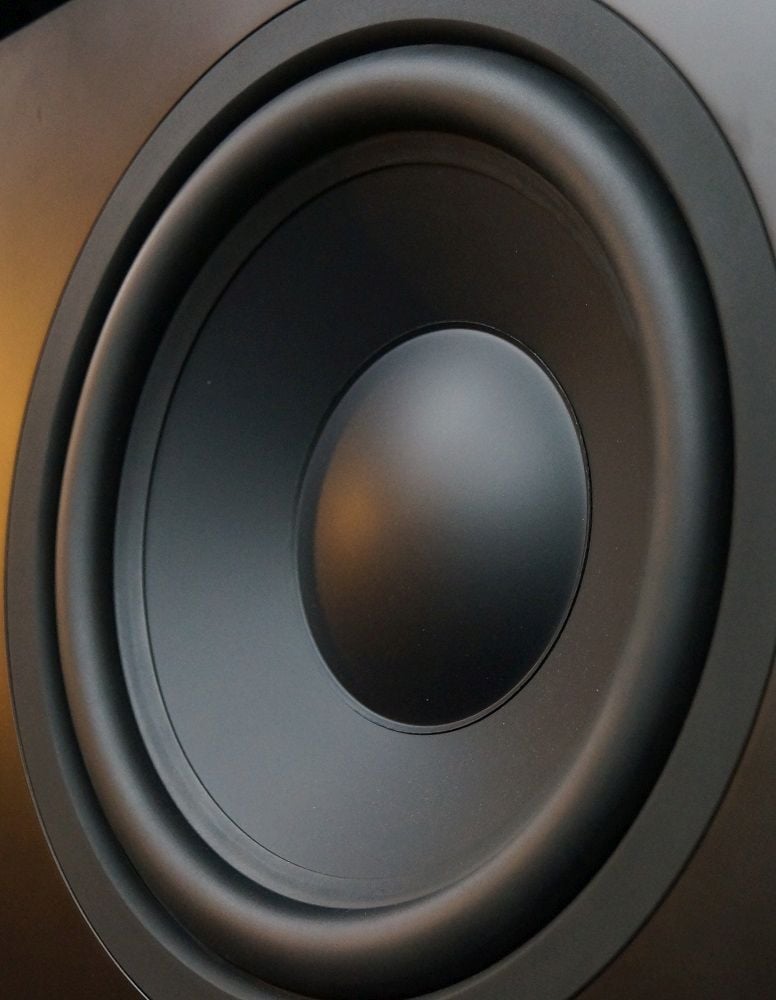

30A coneThe Aurora 30A isn’t a tremendously complex subwoofer, so any design analysis wouldn’t be lengthy. We have a ported enclosure with a 12” driver powered by a 125-watt RMS amp. Let’s dig a bit deeper by talking about the driver. The 30A driver uses the same paper cone that the rest of HECO’s speakers do. The cone is attached to a stamped-steel basket by way of a half-roll surround and Nomex spider. The motor’s magnet has a 5 ½” diameter with a 1 ¼” thickness, and venting is done through the pole piece. It doesn’t look like a massively overbuilt high-excursion driver, but many of the pertinent values for driver performance wouldn’t be visible at a glance. On the whole, it looks commensurate with the cost of the sub.

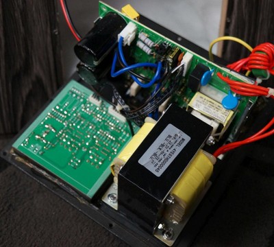

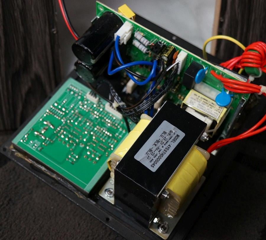

The 125-watt amp is a class-A/B design, and it uses a fairly large transformer and some big capacitors as well as a beefy heatsink. It’s a bit old school in these days of class-D plate amps with DSP, but that isn’t necessarily a bad thing. 125-watt RMS seems a bit weak given the price point of this sub, but there is more to amplifiers than just a wattage spec. Also, Class AB amps with a linear power supply tend to have more dynamic headroom then their Class D counterparts with SMPS. Kudos to HECO for honestly stating the spec, since they could have inflated it and no one would be the wiser. And even with its amplification spec, that doesn’t describe how the power is delivered, how it is sustained, how reliable the unit is, or noise floor or thermal characteristics, among other aspects of operation. As far as loudness goes, the sensitivity of the driver has a whole lot more say in that respect than the raw wattage from the amp. A high-sensitivity driver can blaze with 125 watts. We would have to look at the end performance before making judgments here. Amp controls are pretty basic with a volume knob, a low-pass filter knob going from 50Hz to 150Hz, a 0-180 degree phase switch, an on/auto-on switch, and a power switch. Connectivity is comprised of left and right RCA inputs. For calibration with a receiver or processor, be sure to set the low-pass filter at its maximum frequency of 150Hz since there is no filter bypass.
30A rear panel   30A amp
The enclosure is made from MDF and uses 1” thick front and top panels, and ⅝” thick side panels. The sides are lined with acoustic stuffing. There isn’t any interior bracing to speak of; perhaps HECO didn’t think it was necessary since the enclosure is relatively small. And it is a small sub for a ported 12”. Having such a small enclosure is going to inevitably reduce deep bass performance. There are two rear-mounted ports that have an 8 ¾” length with a 2 ¾” diameter. Both ends of the ports are flared. The feet are some large rubber circles that HECO terms the ‘Extended Surface Dampers;’ while I think that name for their feet is a bit much, they look to be fine for their task.
The overall design suggests that this is a sub that sacrifices deep bass in favor of a small enclosure. This is not an unreasonable trade-off since so few people have room for a large subwoofer. We can’t expect extremely deep bass, but we can hope for very competent performance within its bandwidth. Let’s see how that plays on in some real-world use…

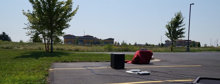

30A outdoor testing
Testing on the HECO Aurora 30A was conducted with the microphone facing the woofer at a 1-meter distance with measurements scaled back to a 2-meter distance by subtracting 6dB. The temperature was recorded at 60F degrees with 90% humidity. The subwoofer’s gain was set to maximum, the phase was set to zero, and the low pass filters were set to maximum.

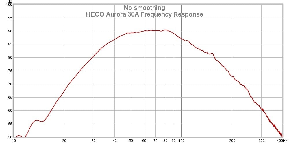

30A frequency response3
The above graph shows the measured frequency responses for the HECO Aurora 30A subwoofer. This isn’t the ruler flat response we see with many DSP’d subs, but that isn’t really a big deal in practice. When placed in a typical room, the acoustics mangle the response of any sub. The 30A doesn’t exhibit a tremendous amount of bandwidth, but it gets the job done. If I had to assign a +/-3dB window to this graph, it might be 35Hz to 110Hz. The roll-off on both ends are somewhat gradual, so usable bandwidth will be outside of this range. As mentioned before, I was getting usable bass in my room down to 30Hz, although it was not as strong as the bass that the 30A could produce at 40Hz and above.

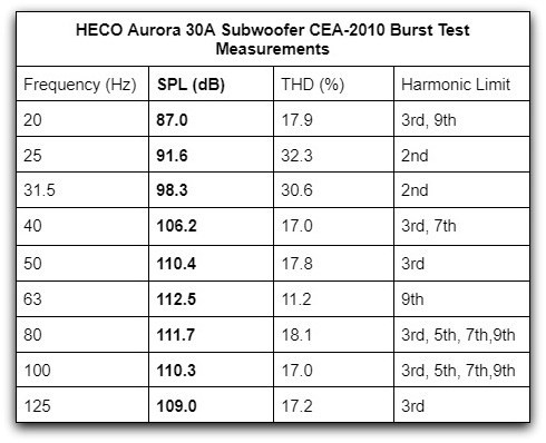

30A CEA-2010 table
The above CEA-2010 measurements are short-term bursts that show the subwoofer’s clean peak SPL before heavy distortion sets in. Our measurements have been referenced to 2-meter RMS, which is 9dB down from the standard requirement for the measurements to be shown at 1-meter peak. However most publicly available CEA-2010 measurements are shown at 2-meter RMS, so we followed that convention.
Bassaaholic smallThe 30A’s burst test SPLs are mostly in line with other $500 subs I have measured, albeit with somewhat less deep bass output below 40Hz, not a surprise given its design. What is surprising is that the 30A is distortion-limited at every frequency. I would guess that the 30A driver doesn’t have a tremendous amount of linear excursion, although some of this distortion may stem from clipping at some stage in the amp. The distortion that was produced during testing was very audible. It should be kept in mind that this testing nears the maximum output limits of the sub, so these large quantities of distortion are not at all present at nominal listening levels. This is what happens when you push the sub to its limits. At lower levels, the 30A produces fairly clean bass. The 30A does attain some pretty respectable mid-bass output, although it is marred by significant distortion quantities. Nonetheless, the sub averages above 110dB from 50Hz and above, and that does pack a punch, as I found out in my listening. One note about these burst test measurements: the port-generated output is fully represented here since I rotated the sub 180 degrees and used the highest numbers that side of the sub produced, which was significantly higher in the port-generated bandwidth, of course. The 30A earns a Bassaholics ‘Small’ Room Rating since it misses the performance targets for 25Hz and 31.5Hz by our criteria. However, its punch at 40Hz and above means it could handle larger rooms if you aren’t worried about deep bass.

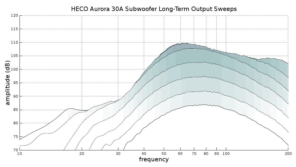

30A compression sweeps
Testing for long-term output compression was done by first conducting a 20-second sweep tone where 50Hz hit 90 dB with the subwoofer 1 meter from the microphone (graph has been scaled to 2 meters for easy comparison with our other review measurements). We then conduct further 20-second sweeps by raising the gain by 5dB until no more output could be wrung out of the subwoofer. These tests show us the long-term continuous headroom that the subwoofer is capable of.
Due to the design of this sub, it is difficult to fully capture all of the acoustic energy of the 30A with a single measurement position. This is because the ports are on the opposite end of the sub from the woofer. This separates these acoustically radiating points by distance and also by the directivity of sound (the bass emitted by subwoofers isn’t totally omnidirectional contrary to popular belief). This measurement was taken at 1 meter from the front of the sub, and in this arrangement, we are missing a substantial amount of port output. Outside of the underrepresented port output, the long-term mid-bass output produced by the 30A is substantial and manages to touch 110dB which is not something any of our other $500 subs could do (with one freakish exception). One oddity of this graph is some low-end output that picks up below port tuning at the higher drive levels. I would guess this is from the system overriding any high-pass filters in place. While output is greatly attenuated below port-tuning, it doesn’t quite drop like a rock off of a cliff. I wouldn’t be surprised if some users had some unexpectedly deep bass from room gain from this effect. However, even with a massive amount of room gain, the deep bass will not have parity with mid-bass at 50Hz or above.

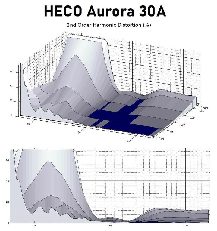

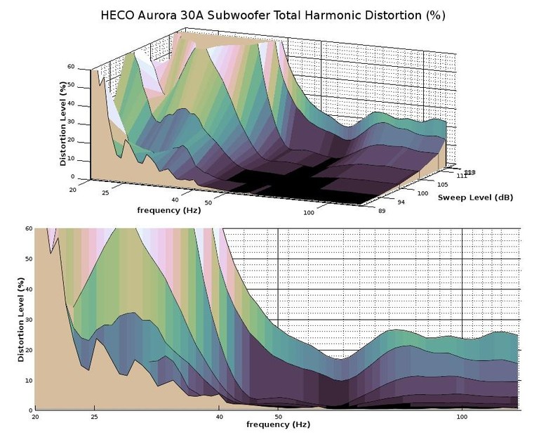

30A THD
The 30A is not a sub I would use to chase deep bass.

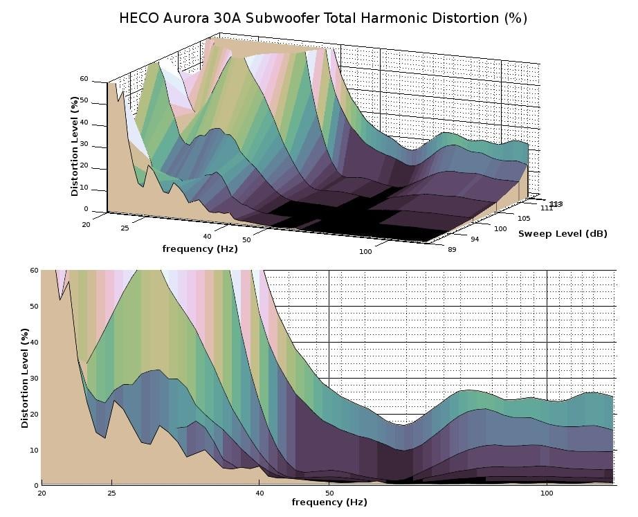

The above graphs show the corresponding total harmonic distortion to the long-term output graphs. Essentially, they depict how linear the subwoofer remains for the corresponding drive level seen in the long-term sweeps. The quantity being measured is how much of the subwoofer’s output is distortion and is shown here as a percentage.
It is easy to see that at high drive levels, the 30A can incur lots of distortion. That shouldn’t cause anyone to overlook the very low distortion at nominal levels. At a steady 90dB, there is barely any distortion above 40Hz, mostly hovering around 1%. Push it harder and it does start to increase, but even the 100dB sweep will not exceed 5% above 45Hz. After that level, distortion does become significant, going from 10% to well over 20% on average in mid-bass when the 30A is pushed hard. This is very loud, as we noted before, touching 110dB around 60Hz, and few people would be driving this sub that hard. Moving on to deep bass, that clearly isn’t this sub’s forte.  At moderate loudness levels, the 30A can dig down to 25Hz without much trouble, although its output is rolling off fast below 30Hz, and I could barely hear anything below 30hz in my room. At higher drive levels, distortion really takes off at 40Hz and below. The 30A is not a sub I would use to chase deep bass.
I went back to watch some very demanding bass content to see how this distortion audibly manifests in some real-world use. One scene that I threw on was the “Pods Rising” scene from the 2005 “War of the Worlds.” The distortion wasn’t obvious but it was there in a thickness of bass in some of the harder low-frequency moments. Mostly the 30A didn’t even try to reproduce the deeper bass of this scene. The same was true for other scenes that I tested, and the sub didn’t run into any blatant distortion unless I cranked it to absurd levels. It largely just omitted playback of bass spectra below its operating range. It was easy to hear in pure tone sine signals, but in actual content, it was not as obvious.

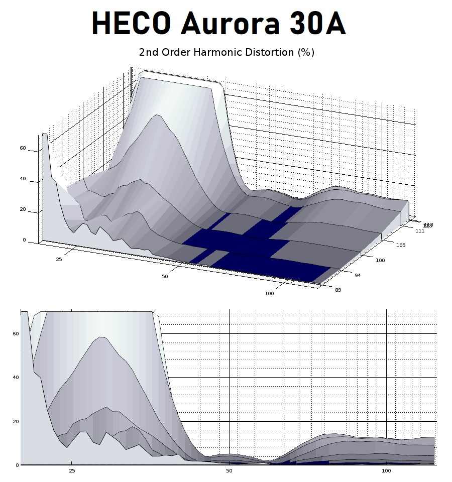

30A 2nd harmonic

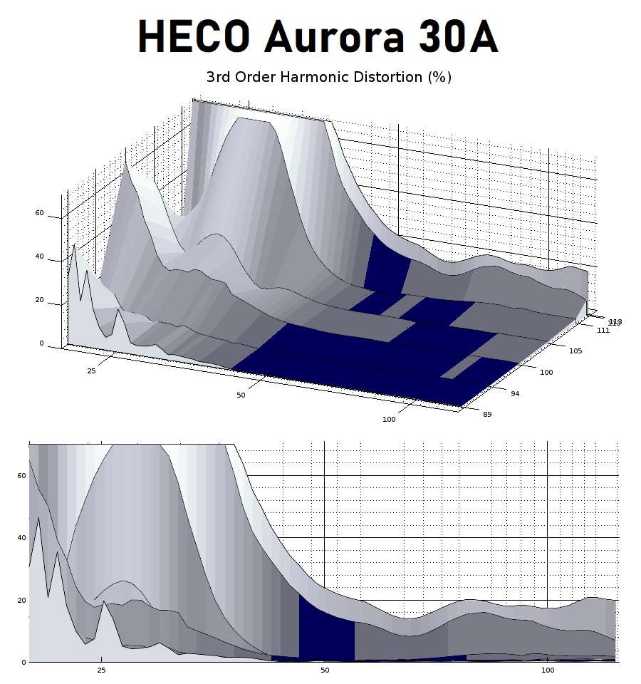

30A 3rd harmonic
The above graphs depict measurements of the constituent harmonics from the long-term output sweeps and are what the total harmonic distortion measurements are composed of for the 2nd and 3rd harmonics. These individual harmonics can give us a clue as to what might be the cause of some quirk or non-linearity. We are only showing the 2nd and 3rd here because they more or less reflect the higher even-order and odd-order behaviors, although higher-order harmonics tend to be much further down as a percentage of distortion compared to the second and third.
At low levels, the 30A has almost no odd-order distortion products and a mild level of even-order distortion. I would guess that the distortion at these levels is mostly from inductance. A shorting ring might lower that, but the audible difference for such minute amounts of distortion isn’t likely to be worth the cost. Distortion really starts to blow up in the last 10dB, especially in the odd-order harmonics. Here the driver is running into the limits of its linear throw, likely reaching the edges of where the magnetic field exerts control over the voice coil. Below this drive level, the coil is in its happy place, at least above 40Hz. I should say that in this scenario, the sound of the distortion that the 30A produced was unusual and not like any sub I have tested. It modulated the signal to sound almost like a musical instrument effects processor. It’s not exactly something desirable for the purposes of fidelity, but it had an interesting sound.

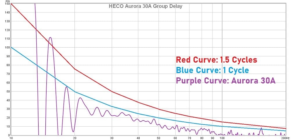

30A group delay 2

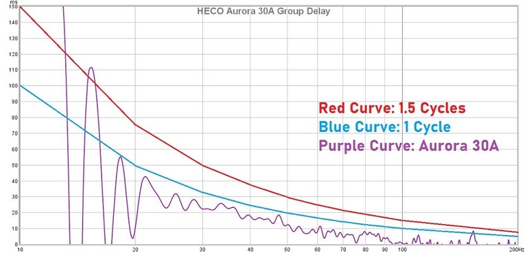

Group delay is the measurement of how much time it takes for individual frequency bands of an input signal to be produced by the speaker. It can indicate that some frequency components are developing slower than others or are taking longer to decay. It is generally thought that 1.5 sound cycles are needed for group delay to be audible at bass frequencies, although there is an argument that group delay should remain under 20ms to be completely unnoticeable, but that is likely meant for mid and upper bass frequencies.
The 30A puts up a good showing; a bit better than I expected given its relatively high tuning frequency. Group delay stays largely under one cycle until 20Hz. I didn’t notice any lag or latency in my time listening to it. Group delay might rocket up below 20Hz, but that is a region with very little output, so it doesn’t make a difference. There just isn’t much to say or complain about in this metric. The 30A does just fine in time domain performance and won’t be the cause of sloppy bass or significant overhang.

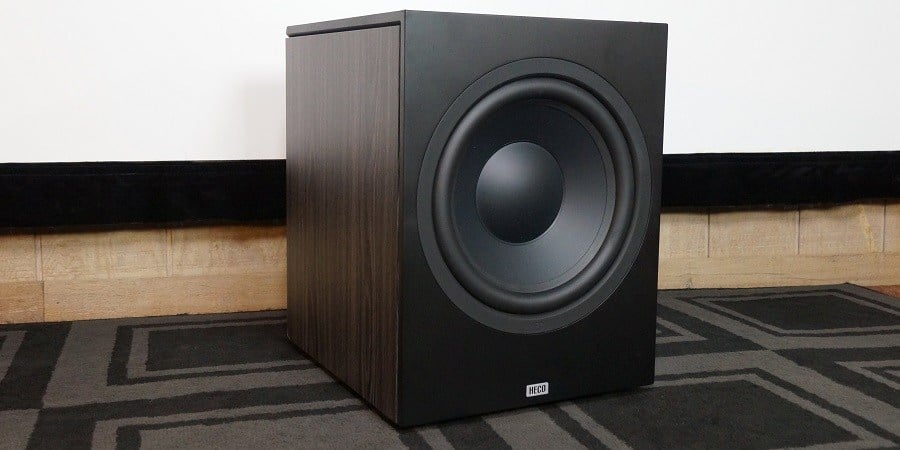

30A hero6
Outside of its performance, the Aurora 30A has to be the nicest-looking sub in its price class. The fact that it is not huge helps a lot for the ‘spouse approval factor’ as well. If you want a modestly priced sub that looks nice and won’t be an eyesore, the 30A does that.
